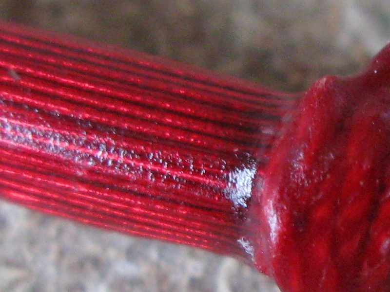

                  Coils
                  I have shielded my coil with Graphite powder on paper. The the graphite is dipped in isopropyl and painted on until it is the right resistance. It is all held in place afterwards with spray paint and then epoxy.
                  The shield is connected with bare wire taped to the bare graphite and then epoxied.
                  The shield is like magic. It stops noise from wet sand and wet grass.
                  The reistance of the shield is I used is 1k ohm.
                  That is 1k ohm per square.
                  (1 square inch, or 30 x 30cm square paper, or 1 square killometre all have the same resistance =1kohm, this is how resistances of surfaces are measured)

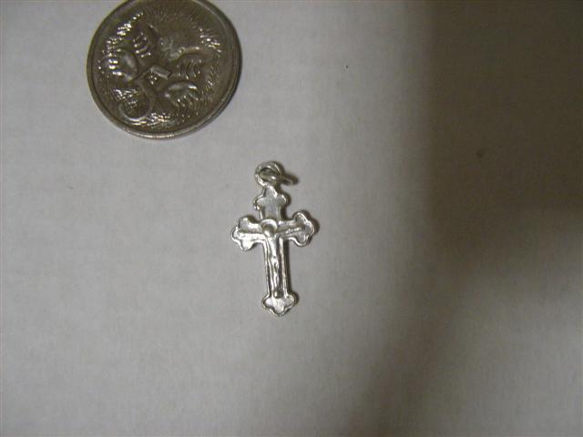

                  I have found tiny silver jewelery (nothing super valuable) in wet low tide sand with this setup.
