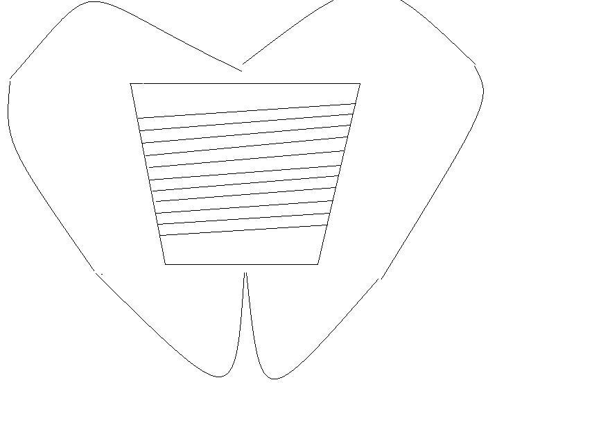

    Anyone got a view on this type of coil..
    A solenoid type with differing diameter ends.
    Narrow end at the base..

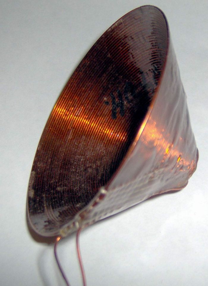

      I make numerous Cone Coils.
      This one is about 3" at top, ans 3/8" at bottom.
      Height is 2" and Inductance is 104uH.
      Good for Bench testing on my PI.
      I also make bigger ones, but don't find them all that good for out door use.

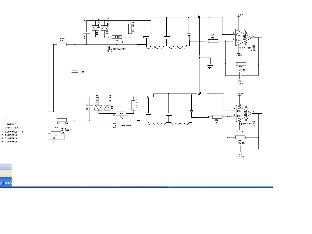

          Oh, it was some work I had done for a guy on here for filtering out of band signals away.
          I must say metal detectors have a lot of interest for me as they encompass lots of engineering disciplines - it fits with my inquiring outlook.
          One thing I think of on a DD coil set is ...
          The centre of the Tx coil has the most signal (target illumination.)
          The centre of the Rx is most sensitive point .
          In a DD the Tx is looking 3" to LHS of target, as is the RX is looking 3" to RHS of target
          This must loose a bunch of depth.
          One thing to try is to angle the coils slightly to get Tx max and Rx max to converge at say 12" depth - like the lamps on the lanc in the dam busters!
