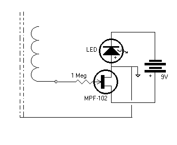

            Here is a way to test the effectiveness of your shield. I got this idea from building an electroscope posted elsewhere on the forum. Actually, a simple spiral wrap of bare wire around your coil can be amazingly effective, even with fairly large gaps between the wraps.
            This will test the effectiveness of shielding from static charges and can sense the charge on a plastic cup from several feet away on an unshielded coil.
            If the LED toggles from dark to light, it is sensing a positive charge.
            If the LED toggles from light to dark, it is sensing a negative charge.
            Don
                        Don
                        Thank you 6666 for posting the link.
                        I am specially impressed with the following sentence: This will test the effectiveness of shielding from static charges and can sense the charge on a plastic cup from several feet away on an unshielded coil.
                        We have still not come to a conclusion of how much static and how much EMI are involved with the coil shielding.
