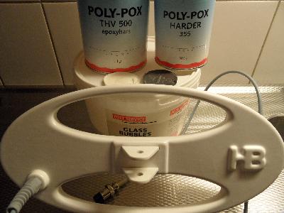

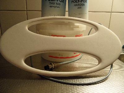

            [QUOTE=Tinkerer; It is a very light white powdery stuff that flies away if you blow on it.
            You mean , Glass Bubbles ?
            Grt Nakky
              Don't use appropriate solvent or thinner.
              Use first epoxy resin,mix this with graphite and glass bubbles and than the hardener.
              Try it first on a small amount.
              Grt Nakky
                Grt Nakky

                    Originally posted by nakky View Post
                    Grt Nakky
                    Nakky - What are you showing us in the pictures you posted?
                    Please explain.
                      Grt Nakky
                      Glass bubbles or micro-balloons, are a filler. Fillers extend the resin and in the case of micro-balloons, make the mix light. This is excellent for casting the coil into the form, but not good for the shield.
                      For the shield we want relative high conductivity but a minimal response to the TX pulse.
                      With undiluted epoxy, we can only make a low conductivity coating. The diluent makes it possible to load a lot of graphite and therefore higher conductivity. The diluent must completely evaporate.
                      Below is a link to Cabosil, one of the fumed silica trade marks.
                      http://www.google.co.ve/url?sa=t&rct...wZnihLlrYecZJg
                      Tinkerer
