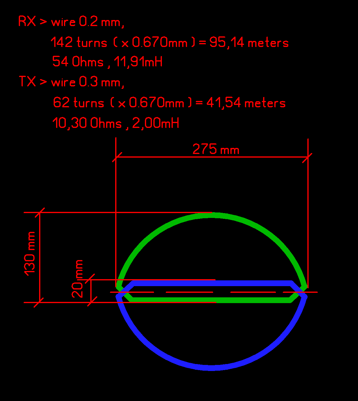

    Hey guys new member here.
    I want to build a small coil for my LOBO ST. Maybe 4" to 6" diameter.
    I think I could calculate the inductance for the new coil, however I don't know what the original coil is. (I don't have inductance meter)

    Here is the method by which You can make your coil.
    http://www.geotech1.com/forums/showthread.php?t=18582
    Here are the data of the coil Lobo, Tejon, Vaquero (one and the same).
    Rx 1-3 r = 4,0-4,3 om f(10H)=48,4-48,7 kHz
    Tx 2-4 r = 63 - 66 om f(10H)=12,05-12,11 kHz
    From these data can make the coil of any size and shape.

        10H are in the generator.
        To do winding, connected to the generator and measure the frequency and resistance. To achieve the required parameters, then make balance, do the screen.
          If I remember right the H on that schematic means nF.
          Your machine runs at 17.8 kHz
          Here is some info on the Original Lobo runing at 20Khz.
          Should put you in the Ball Park

            Yes mine is ~17.8kHz.
            Pins 1 and 3 measure 5.2 ohms
            Pins 2 and 4 measure 88.5 ohms
              27,5sm/2,54=10,8" But to 6 inches.
              6x2,54=15,2sm.
              Need not ellipse, but need a circle. Or may be the ring.
