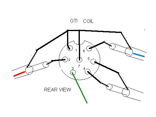

    i bough last summer, garret gti 2500 supreme package, + power dd.
    my cable coil power dd 10"*14" and cable coil imagine seaching 12.5", they had broken, because a car go on my two cable,
    internal wiring damaged and also connector Lkg Line Skt 7-Way broken .
    i cannot send my two coil to repair, because its cost much money to shipping ,
    i could repair it byself , if i have. schematic or picture pinout for 7 pin plug/socket. i could do soldering by self , all i need is shematic or picture , pinout for 7 pin plug/socket
    help me, i'm in big problem, i cannot send back , because its cost me much money,
    waiting for positive answer... geotech1.

          Sorry don't have a photo or drawing
          There are 3 seperate coax, red stripe, blue stripe and white
          Also one green wire.
          GTI series coil 7 pin connector.
          1)Blue stripe shield/Red stipe Shield- RX Gnd
          2)Red stripe Center - RX
          3)green
          4)White center -TX
          5)White shield -TX gnd
          6)Blue stripe center - RX
          7)Jumper to pin 1

              The pins on the connector have numbers. Match
              these to the connector
              PIN 1)Blue stripe shield/Red stipe Shield- RX Gnd
              PIN 2)Red stripe Center - RX
              PIN 3)green
              PIN 4)White center -TX
              PIN 5)White shield -TX gnd
              PIN 6)Blue stripe center - RX
              PIN 7)Jumper to pin 1

                            Altra, you are so so sweet, thank you, i want kiss you , thanks very much, excellent diagram, it so clear, no comment,
                            i been confused because, i didn't understand what means and how it is : Blue stripe shield/ ,
                            i couldn't imagine what is it stripe wire and shield wire, and also center cable,
                            thank you altra, and all memeber and administrator. muaaaaaaah
                              shematic doesn't work, i did all thing, , but doesn't work, plzzzzzzzzzz, verify again your schematic,
