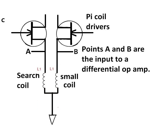

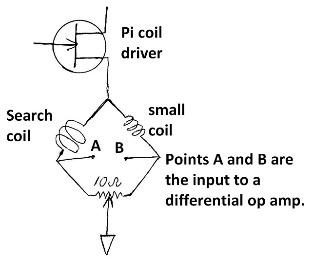

    I have thought about a possible improvement in PI receiver
    coil design but don't know if it is worth doing. The idea seems
    fairly obvious. There are probably good reasons why
    it is not being used. I'd appreciate some feedback.
    Most PI coil designs use damping resistors to eliminate
    receive coil ringing. This changes the received signal to
    a shape that the PI detector can work with.
    Damping coil response reduces its Q and reduces the
    target signal. Can't the unwanted ringing be eliminated by
    using another coil in a bridge arrangement (see attached image)?
    The small coil would have the same inductance as the search coil.
    It could be shielded and put on the main circuit board. It's
    magnetic field would not interact with that of the search coil.
    If the ringing of the small coil was matched that of the search
    coil it should be able to cancel out the search coil ringing
    at the input of the differential op amp. Any remaining ringing mismatch
    could be adjusted out by large damping resistors across one or both coils.
    Larger damping resistors would have much less of a detrimental
    effect than the original damping resistors.
    I would like some feedback on this idea. Has it been tried before?

    Coil Drivers
    The previous diagram was only intended to explain the concept.
    A real circuit would use synchronously driven but separate coil drivers.
    When the high current driver pulse was turned off, each coil would be in
    a separate high impedance circuit. Each coil would then start ringing
    independently of the other.
    If all components are well matched the ringings should start to cancel each other out.
    It might be too difficult to cancel out the ringing if there are many ring cycles in the waveform.
    Damping resistors across each coil would used to reduce the ringing to
    a few cycles (say 3 or less). This should make possible a finely tuned ringing cancellation
    that will leave only a stronger than normal search coil target signal at the differential op amp.
    If the ringing is well canceled out it might also be possible to start sampling at an earlier
    point in the received signal.
    My questions for the forum experts:
    1) will a circuit of this type have the advantages I described?
    2) If so is a circuit of this type be stable enough to be practical?

          Your feedback was valuable. I now can see why my idea won't work.
          Induction balancing the RX coil with the TX coil should eliminate RX coil ringing and allow only the target signal to be received. TX coil ringing is still a problem.
          You have to wait for the TX coil ringing to dampen out to a reasonable level before looking at the target signal. Ideally, if the TX pulse was a step function, target sampling could begin immediately after the step.
          With that in mind, I can see why my proposal would NOT work.
          Ideally you want to expose the target to a single strong step pulse.
          My proposal exposes the target to multiple ringing cycles. This make things worse.
          You would have to wait for the effects of ringing on the target to die down before sampling the received signal. The effects of ringing on the signal would make it too
          weak to be usable. Looks like it's time to go back to the drawing board!

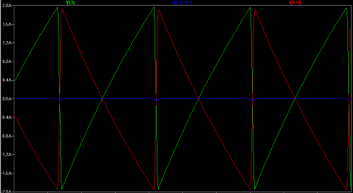

                    So let's look at it in more detail.
                    The TX step function, generates a Flyback of several hundred volts. The RX coil picks this up because the TX and RX coils are transformer coupled.
                    To reduce this Flyback in the RX coil, we add a Bucking coil made of a few turns, about 5% of the inductance of the TX coil. The Bucking coil is in series with the TX coil, but 180 degrees apart, so it generates a counter Flyback that nulls the TX Flyback.
                    Attached is a simulation that shows the above. I have also attached the LTSpice file, so you can experiment with different settings.
                    The yellow trace shows the TX coil current.
                    The red trace shows the Bucking coil current.
                    The blue trace shows the sum of the TX coil and the Bu coil currents.
                    R5 is a bypass. Coils in series have normally the same current. However, if we have a slight unbalance, the bypass allows to compensate for that by making the current different in the 2 coils.
                    You see no oscillations on the simulation. This is because the simulation is not perfect. In fact, there are always some HF oscillations at the Mosfet switch ON and OFF. These are the oscillations you see on the RX signal after damping.
                    Reducing these oscillations would help increasing the sensitivity. Mind, the sensitivity is quite high already, but we want to improve it still more.
                    Tinkerer
                      I just managed to reproduce the switching oscillations in the simulation.
                      So now we can investigate what produces them.
                      It looks like it is stray inductance, but I will investigate further.
                      Tinkerer
