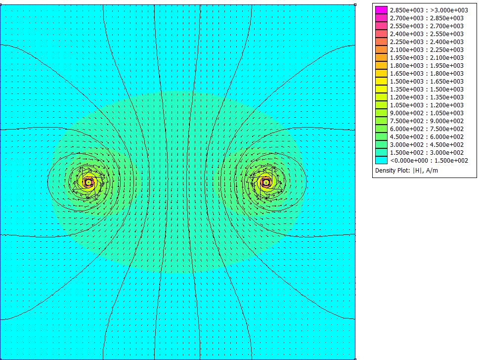

    We all are familiar with using spice software for simulating electronics, but how about simulating the magnetic fields generated by search coils with the help of free software? The reason I want to simulate is to get a better understanding of the different coil shapes, but also how a coil will behave with different types of soil.
    I came across femm 4.2 and spent a couple of hours getting familiar with the software. To start I have simulated a simple coil with 100 windings of 0.8 mm wire in air. The diameter is 30 cm. It is driven with 1 Amp at 10 kHz. What you see in the picture is the field strength in ampere per meter, flux lines and field direction (the little arrows).
    Attached is the simulation fille. Save it to your disk, rename to 30cmcoil.FEM and load it into femm. Select Mesh->Create Mesh from the menu. Next select Analysis->Analyze and Analysis->View Result. Click on the coloured button next to the arrow button for a contour plot.

            hello joop
            if i follow your steps there comes an error message at the point when i choose
            show results - can find 30cmcoil.fem.ans?
            did you have this ans, can you upload it?
              Hi Bernt.
              the .ans file is the result of the simulation. I think you incorrectly renamed my file. Be sure to name it 30cmcoil.FEM, not 30cmcoil.fem.
