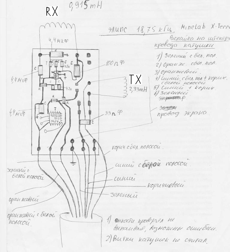

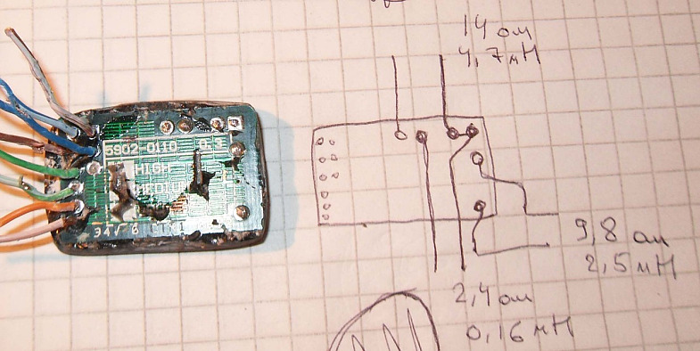

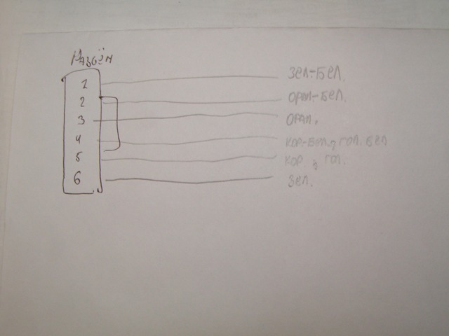

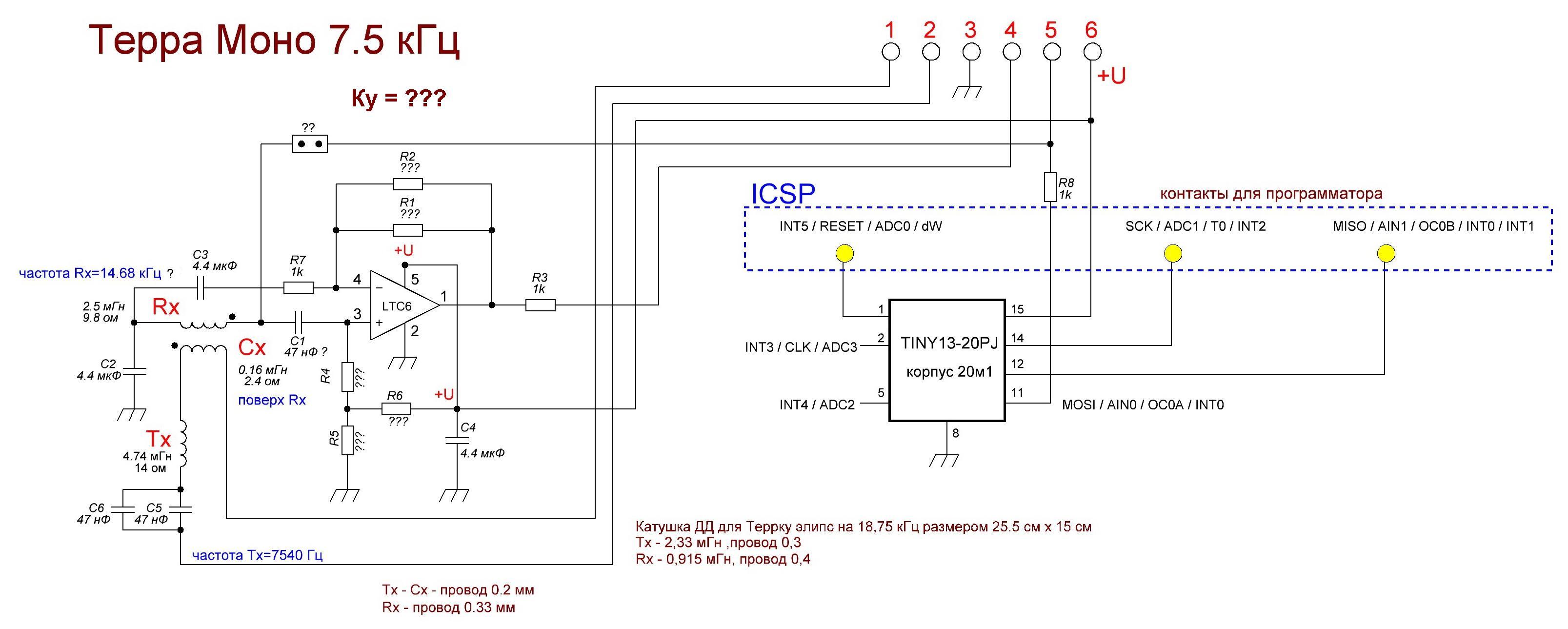

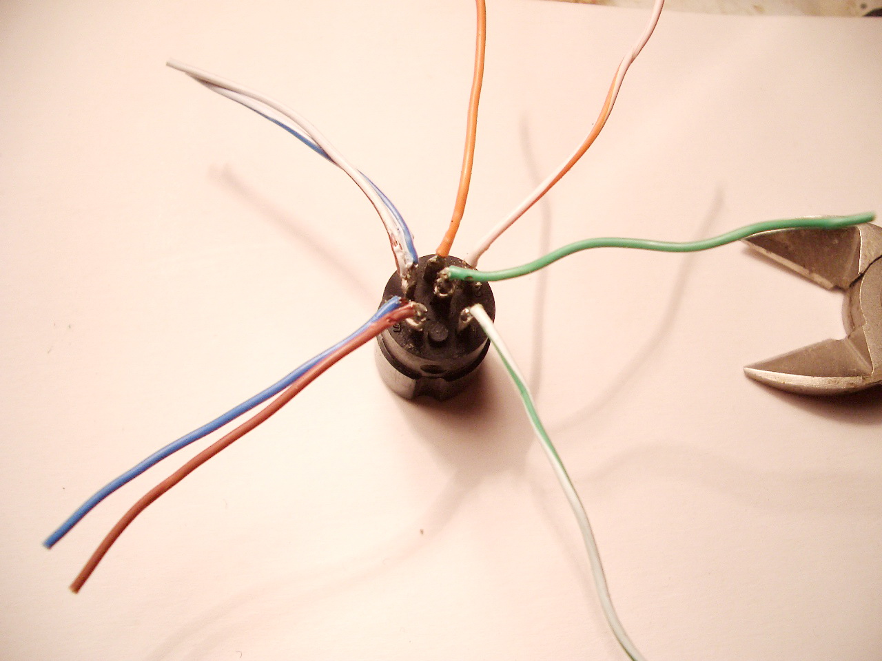

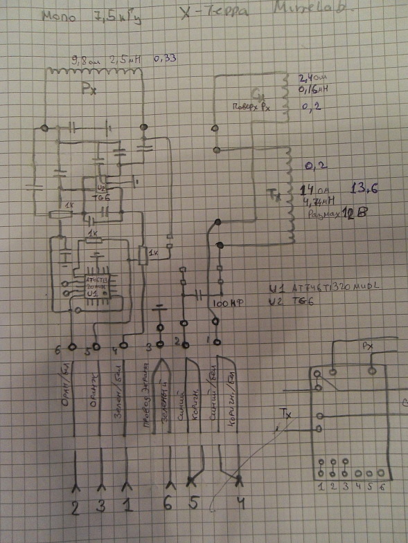

Minelab X-Terra coil inside. Schematic.
    Great work from our Russian colleagues (and ML Lab of course).
    Thanks KT315.
      Good job KT315.

        VFLEX transforms conventional single frequency metal detection technology by including two microcontrollers (miniature computers), one inside the control box and one inside the coil.
        a microcontroller inside the coil RECOGNISES the Minelab coil. it does NOTHING! no more! it transfers some code in a block at turn-on first time. same principle is used in aircraft tech in recognizer SELF-ALIEN.

            This is a fact. WM9731 codec involved in digital signal processing is located on the motherboard. I do not see the connection between computers in the coil and the detector.

              IF ML is to be believed (and they are probably NOT) then why not just have an E2PROM in the head and read the parameters for it using I2C (could also contain nulling parameters too etc) OMG I just gave ML an idea..Watch them patent that now and call it was THEIR idea..
              So, the micro can't generate enough of a signal to be used as Tx generator (of much practical use) and the ADC doesn't have enough resolution NOR is the micro fast enough to be doing front end signal processing.
              SOooo, I suspect I am right with the info above. Interesting that ML's engineers (note the small "e") using a sledghammer to crack a walnut, but then the AT Tiny is probably cheaper than a E2PROM OR they aren't smart enough to understand and use I2C!
              Bluntly and, more truthfully, VFLEX = (More) smoke and mirrors sales hype designed to part gullible people from their money..
                Sean, you can take off this TINY chip from a coil, set in your block. you will get a possibility to connect any your self made coil and ALL their protective tech will be only 'the last of discovery s-t' (TM).
                  They could have used simple serial-access memory parts, eg. the 'one-wire' system, that would be enough to identify the coil frequency and size and any other operating parameters. Systems like that are used in laptop batteries to identify genuine parts. But it would be easily copied by after-market manufacturers. Putting in a micro allows simple encryption code, etc, and it would be hard to read out the code and reverse engineer the coil. I'm sure the same thing is done by printer manufacturers with ink cartridges.
                    ROFLMAO!!
                    Nope even WITH the TiNY you can just look at the data line wiggling about and work out what is going on (OR you could try a logic analyser).
                    I DO suspect that the "code" it spews out is "encrypted" in some way but still not hard to reproduce unless it is challenge and response type, but I dont think ML are smart enough to have thought of that!
                    What you need is to look at ALL types of coil they use and look at what is "emitted" each time at switch on. MAYBE it's a rolling code (like car alarms etc) but even then a few hours with an on/off sequence might yield enough data to make the sequence predictable.
                    In any case, I suspect that if you pay ML a LARGE sum of green stuff and tell them you want to make aftermarket coils they will send you a VERY wordy NDA and let you have the codes anyhow.
                      Rolling codes is exactly what I was thinking, (not rolling on the floor). They're just trying to make it difficult, not impossible. I'm sure reverse engineering could be done. By the way, do you still have access to the programmer that can read security-bit protected micro's?
                        I don't know if you were aware, but ML changed the data protocol/encryption of the V-flex system, meaning non-official NEL aftermarket coils won't work on the latest (mid-2012 onwards) X-terra's.It could be that the NEL coils did not include a straightforward clone of the ML chip, to avoid copyright-type issues, but they were functionally compatible, based on reverse-engineering. This would be their weakness.http://www.minelab.com/aus/customer-...?article=94380
                          Hi I have got broken standard coil to x-terra 70 (7.5kHz) I think that she is unbalanced (falses all the time). I wanted to use PCB from it and build bigger DD coil. Can someone help with coil data/windings?
                          I know there is thread on md4u:
                          http://md4u.ru/viewtopic.php?t=2453
                          but there is no data, maybe someone has it, resonanse freq. etc ?
                            Did you look at Kit315's files in post number 1 of this thread?
                              Yes, but this is for 18,75kHz not 7.5kHz coil soe i thing inductances may be different , and there is just L no resistances and wire gauge
