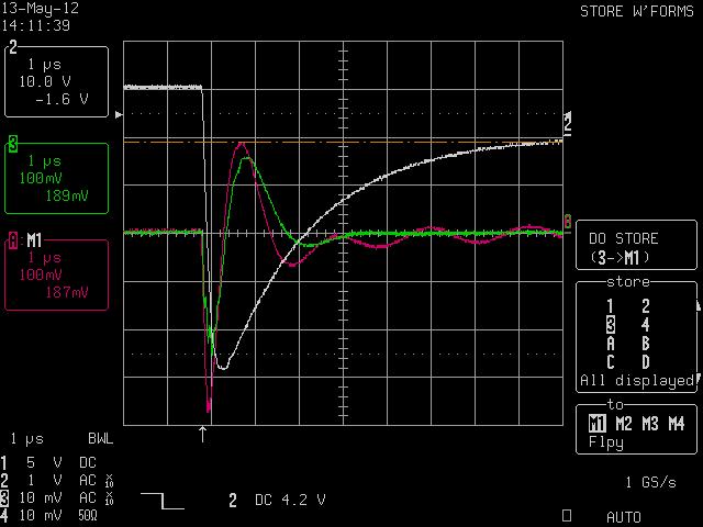

      How does the signal received on the receive coil compare to the 11" coil that you repaired? I saw in the other thread that there is a decaying sine wave signal on the rx coil. This does not sound right. The rx coil should follow what the tx coil is doing, but the flyback spike should be much smaller, due to it being an induction balanced coil. As far as capacitance goes, the coil needs to be settled(front end fets on and preamp settled) before the first sample is taken. Check the test points for the front end and find where the earliest sample is being taken by testing the control signals for the demodulators.
      How does the coil go when you set the coil switch to "E"? This should be mono mode. It should be more sensitive than in "N" You would be better off with a dedicated mono coil IMHO.

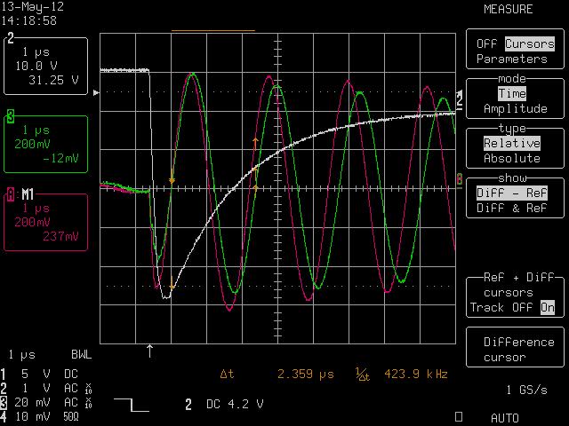

        Hi Mick,
        My testing with the scope was on the Surf PI board but too crude - I used it to drive the TX coil but RX signal was floating when I looked at it and saw the decaying sine. Does the RX coil circuit have a damping resistor at the coil? I'll go back to the 11" as you suggest and get comparative scope shots. But reflecting back on the experience with the second 11" coil I had that may not tell me enough. In fact, this 18" is a lot like that 11". I don't get how it supposedly work better on another detector than this one. If capacitance is the issue it shouldn't.
        Are guys actually taking these DD coils and using them with the Surf PI? How is that done?
          Attached are two files. First is a shot of the TX with RX of both 11" and 18" coils but with 750 ohm damping resistor on RX at the connector. The next one is without the RX damping resistor. Here you can see that the 18" has a lower frequency "ping".
