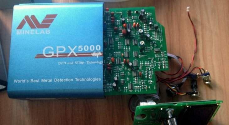

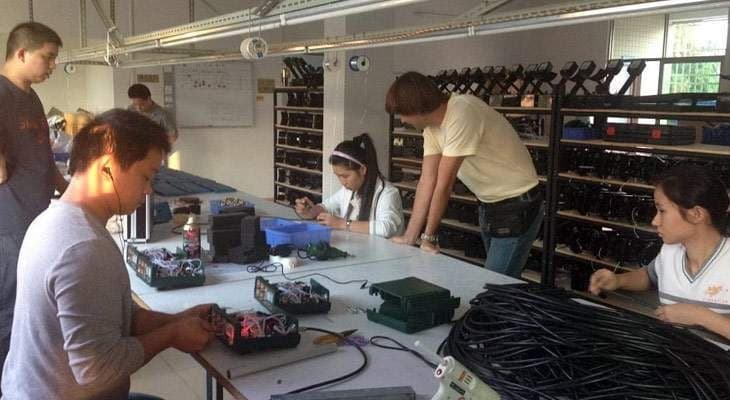

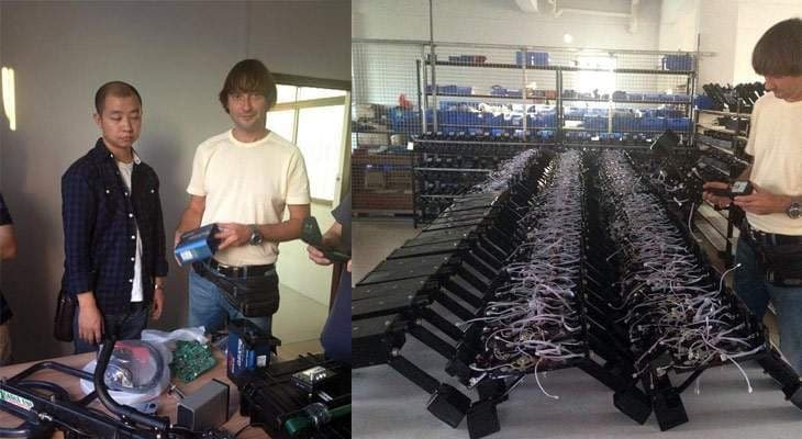

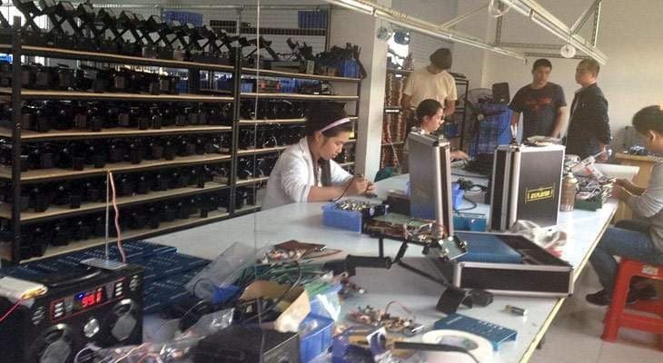

          Hello
          Dear All
          See attached, fake GPX but its performance is exactly like real GPX!

                Thats not a clone, its fake looking at the board pictured there.
                  ok. i ask not on your matter but i did see a video. why your country in those squares? who did this huge job?
                      I agree! It's probably a VLF/TR? Notice how smooth sounding it is in the house around electricity.
                        Yes its not even Pi. I have couple of GPX5000 and a real close clone, not going to advertise the clone so no names. The front end op amp of the clone is ne5534 instead of ad797 but everything else is top notch. Im going to compare these units this week or when i find the time. Im guessing close results of the original vs clone, less smooth threshold perhaps on the clone.
                          Yes the ones in the pics are fakes,the clone 5000 detectors are almost identical to the originals,they just use different components in a few places,the manufactures of the clones could never figure out how to calibrate the earth field
                          after the manufacturing was complete,and so the clones went to market with earth field issues,interestingly the calibration process is just an inbuilt procedure on the detector,but they never new how to enable it.

                            My respects ZED , i don't believe they couldn't maybe they didn't want to?! Otherwise clone gpx 5000 not at all pi detector ! One man bought it and came to me had a problem with the button it was factory defective I replaced it with him when I opened it the tile had nothing to do with the original it is actually a VLF detector as Eclipse said i have them somewhere in some hard drive if i find a setup of them...
                              Orbit what you describe are fakes,the clones i mention are exact component for component replicas,track layout,component layout,even the trannys are the same,partys that i know have sent me pics of these clones that they bought,and asked if i can help them resolve the earth field issue,they even contacted the manufacturer about the problem and at the time they were interested in if we could fix this issue,that was a while ago and from what i understand the clone problem has been eliminated.
