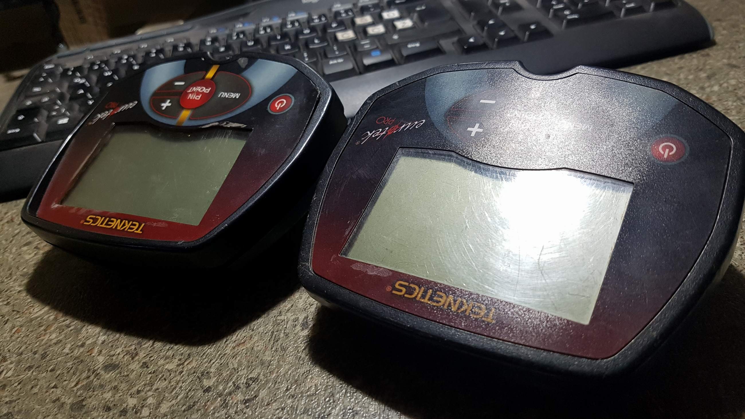

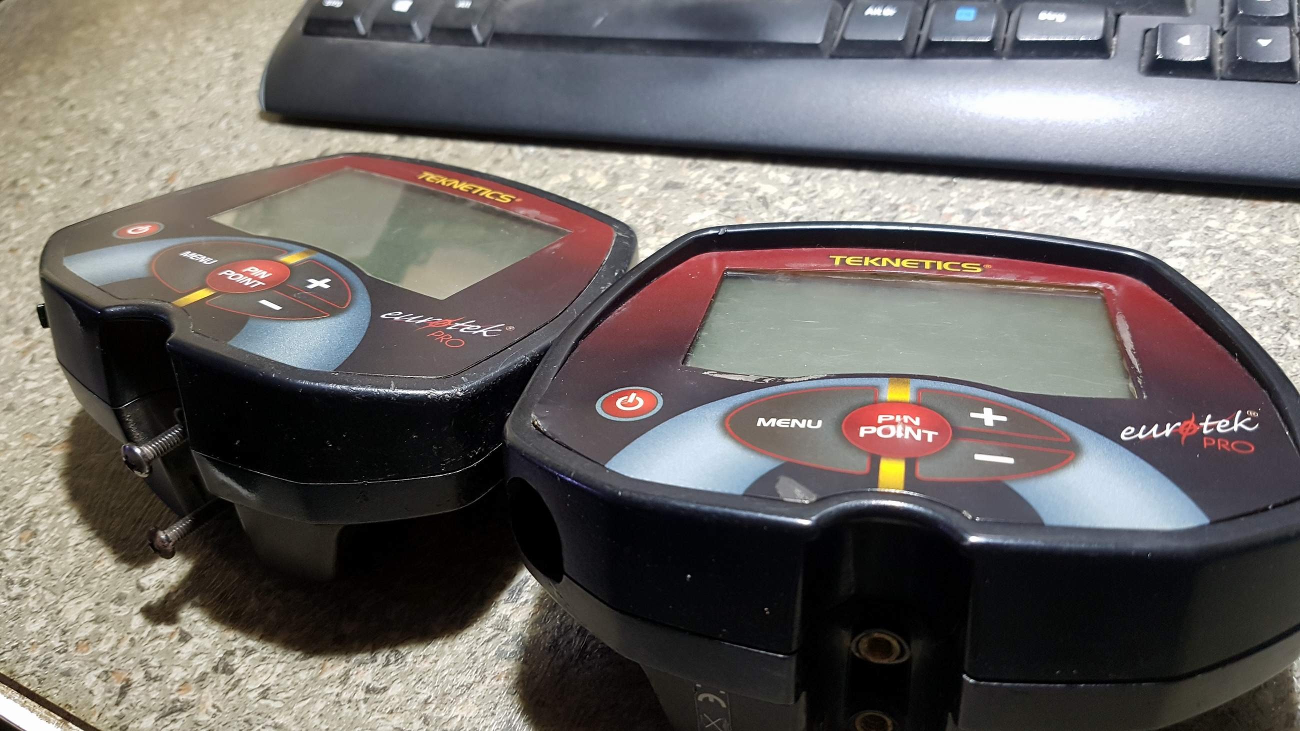

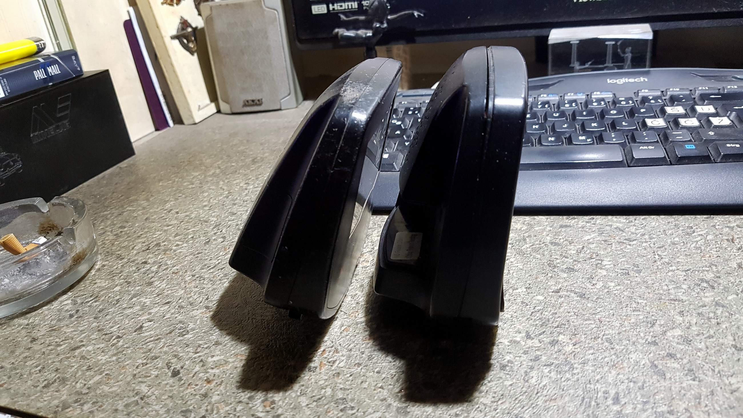

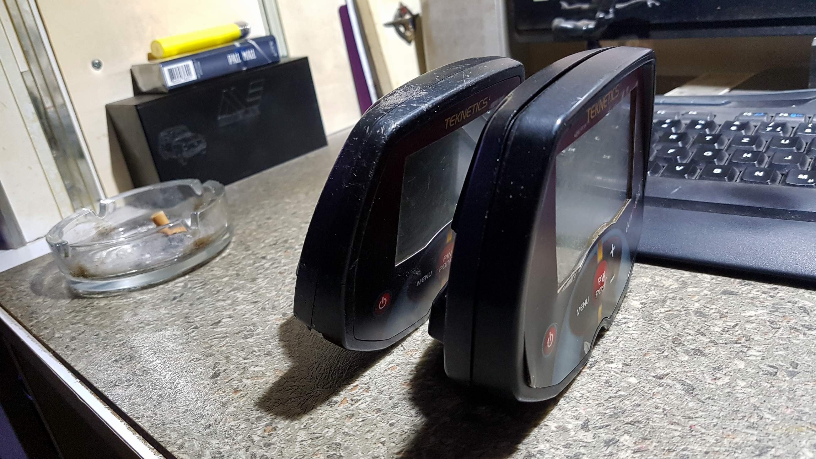

                  Both detectors are Eurotek Pro. But their cases are slightly different in design!???
                  Carl do you know anything about that?
                  Is it a Chinese copy, one of the two?
                  Or did Teknetics decide to change the design a bit in a new series?
                  The latter seems pointless to me, an unnecessary expense, to change the housing molds around such small and unimportant details?
                  Click image for larger version  Name:	20231118_211712.jpg Views:	0 Size:	675.8 KB ID:	416918Click image for larger version  Name:	20231118_211732.jpg Views:	0 Size:	720.3 KB ID:	416919Click image for larger version  Name:	20231118_211736.jpg Views:	0 Size:	665.2 KB ID:	416920Click image for larger version  Name:	20231118_211748.jpg Views:	0 Size:	487.1 KB ID:	416921​​​​
                    The design was changed at some point to use a proper 1/4" headphone jack and to surface mount the coil connector.

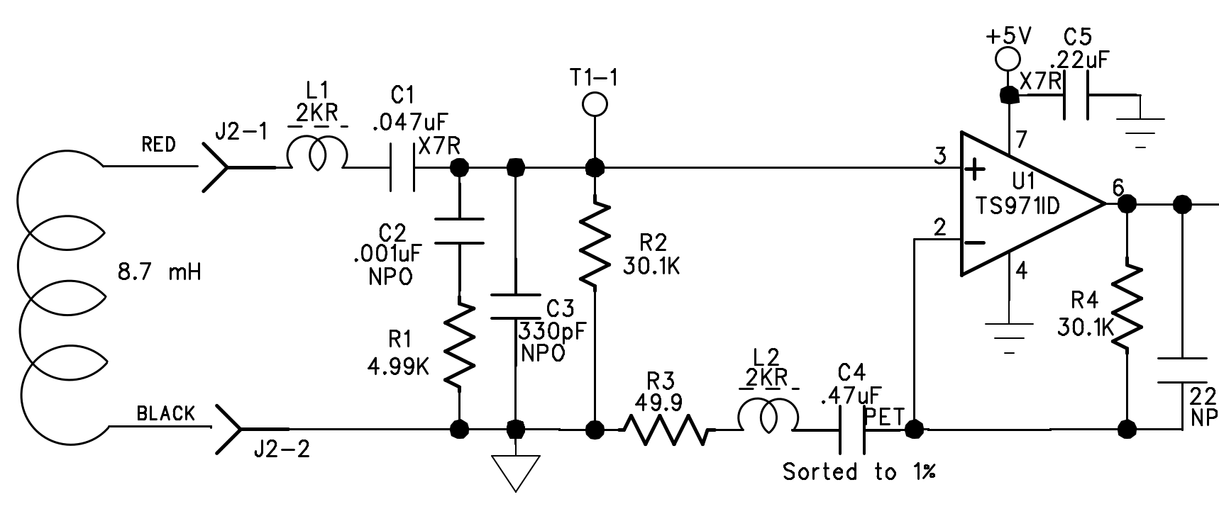

                    Here is the TX schematic. Test point 8-1 should be a pulse from the micro at ~19kHz.

                      RX input:
                        The design was changed at some point to use a proper 1/4" headphone jack and to surface mount the coil connector.​..
                        Thanks!
                        But have you payed attention on details on photos above?
                        On both​ there is 1/4" hp jack and on both coil connector is NOT surface mount, but connected with wires.
                        Differences are in volume and shapes of enclosure. So visible if you pay attention.
                        Click on photo to get hires one. Easier to spot the differences.
                          No easy job for me.

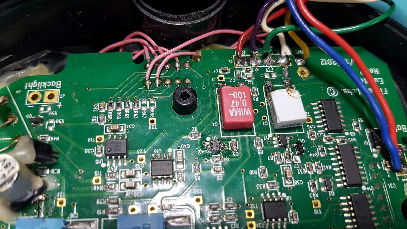

                          TX is alright, I changed Q1 anyway. Same thing. I get nice sinus 9Vpp on the osciloscope.
                          Schematic of TX matches and everything looks fine.
                          However... RX is confusing, not matching the situation I have on pcb here.
                          U1 (supposedly TS971 on your schematic) is small SMD 6 pin chip.
                          I downloaded TS971 datasheet and there is no 6 pin package described in it.
                          Observing your schematic i can trace some of the traces.
                          Red goes through C1 (no L1 from schematic ???) directly to "+" (I assume it is "+") input of the 6 pin chip.
                          But Black is going only up to C4 and further I can't trace it.
                          If take that Red goes to pin 3. then previous to it logically should be pin 2.
                          At 6 pin case then on the other side there are pins 4, 5 and 6 by common logic.
                          So Black should be connected to pin 2. through the R3 (it is present and ok), L2 (not existing on pcb) and C4 (present and ok).
                          But the other side of C4 I am not able to trace with simple buzzer.
                          PCB does not look broken nor any trace too.
                          Just for the sake of experiment I added a wire connecting the othe end of C4 with pin 2.
                          Switching ON and after boot sequence it starts cackling like a chicken.
                          Before that , forgot to mention; with buzzer I discovered that pin 2. and pin 5. are connected togather (probably bellow the chip, since I can't see the trace) or the chip is burned and shorted those two pins.
                          So the problem is in RX.
                          Would be easier if I do know for sure what the 6 pin chip really is?
                          And its pin assignments.
                          That part is not matching with schematic.
                          Click image for larger version  Name:	20231120_124454.jpg Views:	0 Size:	327.0 KB ID:	416959Click image for larger version  Name:	20231120_124509.jpg Views:	0 Size:	318.4 KB ID:	416960​​
                            U1 =LTAFJ =LT6230CS6

                              That makes more sense now, thanks!
                              So, the ENABLE pin 5. is probably tied to pin 2. (V-) normally?
                              Or not?
                                I don't know why the enclosures are different since they both have wired coil connectors. That was long before I arrived.
                                The LT6230 was used in the 1st-gen circuits. Then changed to the TS971. I don't have the old schematic.
                                Black should be connected to ground. The (-) input of U1 should have an RLC circuit to ground, though I don't know the order. It's possible there is no L2 in the 1st-gen design.
                                Yes, you would tie /EN to V-.
