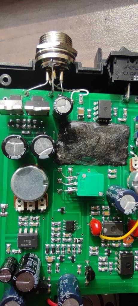

          PCB​:

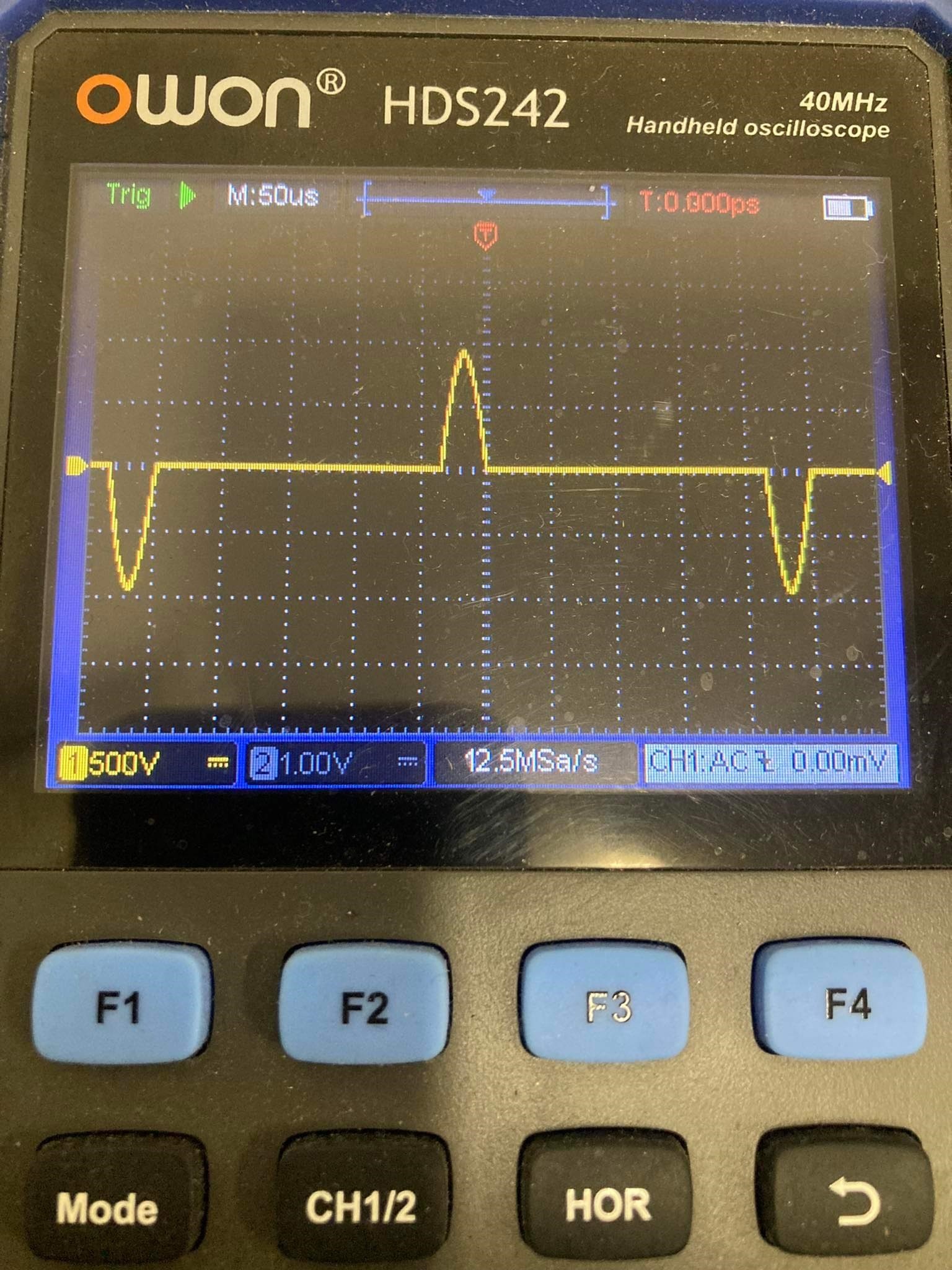

            About working frequency 2 kHz Tx is more like a Time Domain with 500 us period and 30 us bipolar pulses on 250 us delay between pulses
            Click image for larger version  Name:	03562e93-9f74-4e80-b151-64a74061d6a0.jpg Views:	0 Size:	531.9 KB ID:	423015
              Is this measuring the TX voltage or the TX current?

                        The PCB looks like built by a school student.
                        I don't have any personal experience with this detector. There is some positive feedback on the Bulgarian forums. I don't say the detector is not good. Just I didn't expect to see such PCB in a detector marketed as a "breakthrough" and at that price.
                          Look like a direct measurement across the coil ... note the volts per division is set to 500 volts ... those peaks are around 800 - 900 volts. So that means is a bipolar pulsing ... I get very similiar results from the CCPI with the grounded coil setup ( so the flybacks swing + / - as well as the current ).
                          They must have a big capacitance in there the flybacks are about 25 microseconds ... the TX current would be fairly high under these conditions.
                            The measurement was made with a coil close to the antenna. I didn't want to open the detector because of the warranty
                              Fair enough ... may I ask what sort of coil you used and how close to the detector ?
                              Thanks.
