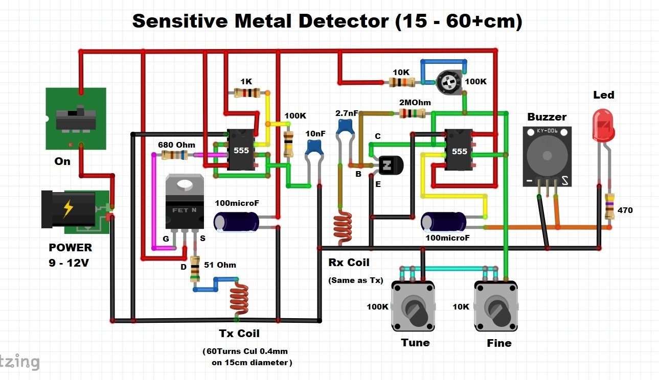

    I am a Beginner and I want a simple circle that uses Timer 555 reveal me the vacuum
    a game 'what i did bring to you from global net'?

      I want a circuit to check the vacuum
      The picture is an example of a simple circuit that can be built and parts are available
      I repeat, I am a beginner
      Thank you again
        my english is poor... not understood... what you mean 'to check the vacuum'? why you choiced metal detector for the check?
          ​I use the translator
          There are metal detectors that give a negative signal when there is a vacuum
          Use analog indicator with speaker

            I think you are looking for an underground void. Most metal detectors can do this, some better than others. I would start with a basic TR detector. Not sure of what is available with a 555 timer.
