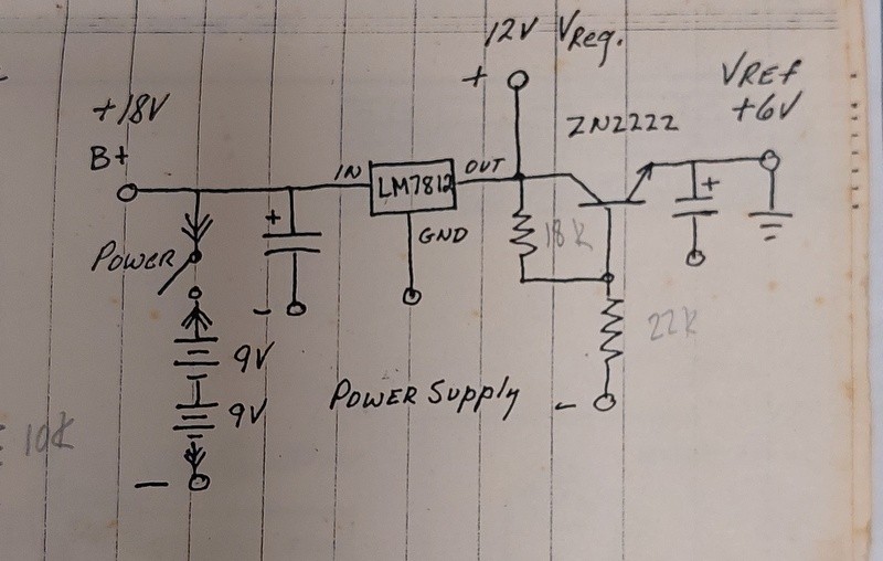

                      ​Without an oscilliscope you can open up the coil connector on the 15in coil. Look for shorted or broken wires. Those coils have a preamp inside that run directly off the 12v regulator. I am a little confused about the situation. You have two detectors, one 10in coil and a 15in coil. One of the detectors works only with the 10" coil and the second detector not at all. A short in coil could have damaged the LM78L12 voltage regulator in the dead detector. Coils rarely go bad internally, most of the time it is a cable problem at the connector end or where it enters the coil housing
                      Looking at the schematic, the newer units used a negative voltage generator and a npn transistor as a 10v regulator. The older units had the LM78l12 regulator. either way, a short could damage the regulator
                      Click image for larger version  Name:	20250309_141814.jpg Views:	0 Size:	83.4 KB ID:	435035
