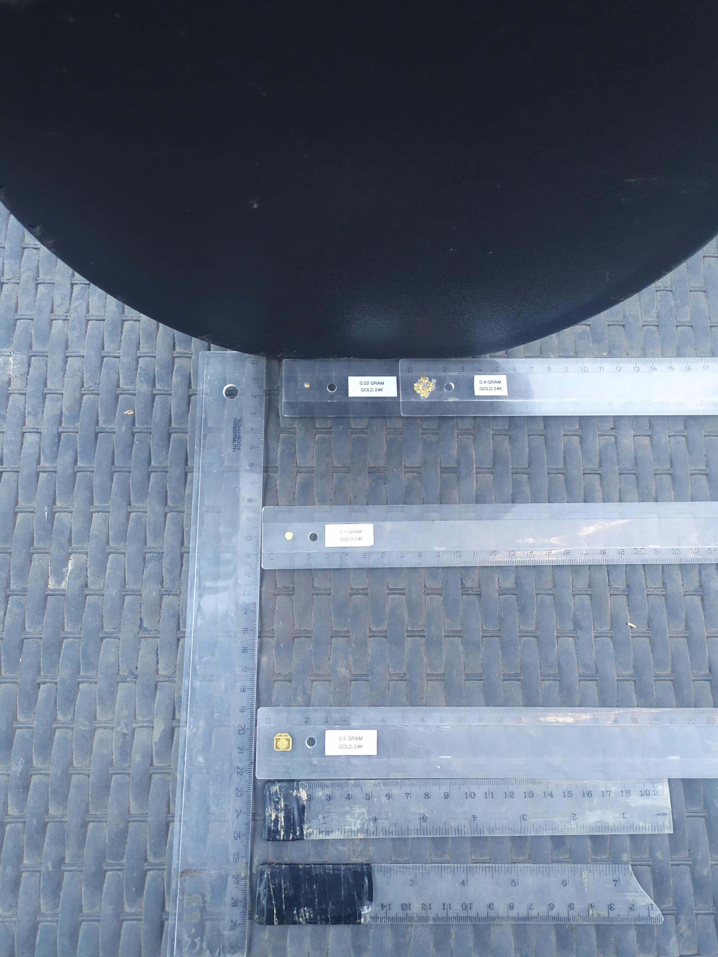

        ATX has a range of 10-10.5cm on a similar large coil without *GB, and over 5 cm after GB on strongly magnetite terrain..
        what more... in my testing.. ATX detects this 0.1 gram /24k/gold under an ironstone...​The results for such small gold are basic...
          show as 0.1g gold and stone = picture
            Picture : Airtest ATX 12x10" coil in mode BG Off
