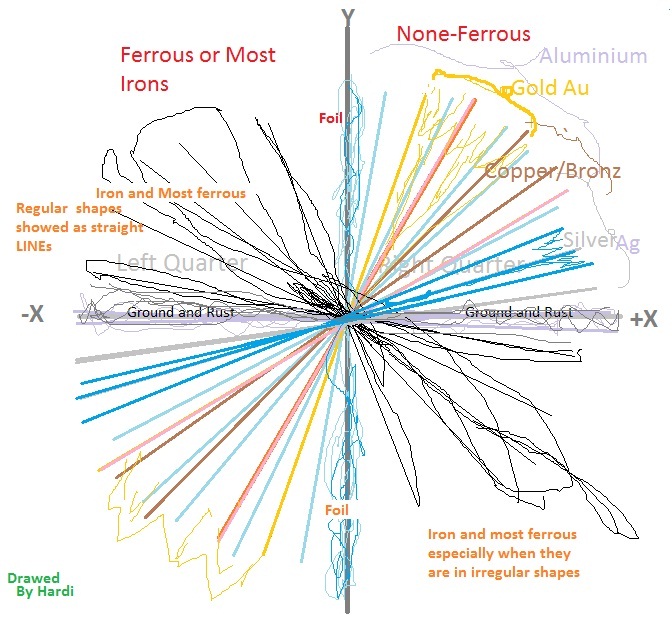

"lissajous" - look a like X,Y coordinate detection display is very interesting, must say!Originally posted by WM6 View PostBy dirty winter here, in first line.
I took it yesterday afternoon outdoor (unlike at your place; here is warm like in Spring, today 15 degrees!!!).
So i checked practical aspects of using those 2 unpublished modes.
X,Y coordinate detection display i founded as very interesting and useful in iron type and size distinguishing! Wow!
Now i can pretty successfully predict what kind&size of iron i detected before digging!
Very useful at some situations!
The other one option, "GB history", is very handy when you want to only walk bit faster and analyze soil condition.
Let's say you want to examine soil mineralization at some smaller area, let say 20x20 meters.
So you switch Deus to "GB history" and walk, don't mind on eventual detection, just observe LCD graphs.
You will see what kind of soil is that in just several steps, so later you will know what to expect relating soil conditions there.
I don't know why they from XP didn't published these two options? Why hiding them?
They are useful so as i saw.

I have got hands upon the deus v2 just just from about 2 weeks ago. I found it is realy impressing new users. I have used as test-try only in AIR as many differnt items as I could hold near the coil. I found it (as ivconic said some where in this forum) has advanced MD for decades forward. I honestly been impressed by perfrmans of Deus.
Regarding XY visulization, I have found the discrimination is very good and clear besides the Target Volume visualization. For example: You can clearly see the ferros in the (-)Minus quarter i.e. up-left quarter between the X and Y coordinates. Similarly you can see the non-ferrous in the (+) quarter or up-right quarter. More interestingly you can see foil and ironic-weak signals exactly on and Vertical and horizontal (X&Y) Axises. The ground efect, small ugly iron-nails, rust are tied or showed slity over the X-axis. The same for Foil and thin Alominum signals are drawed a companied or twisted to Y-axis. You may see it on the image-below.
