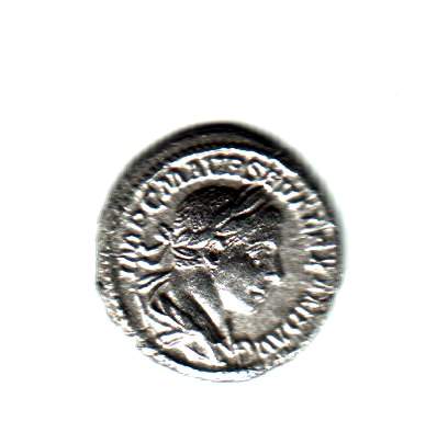

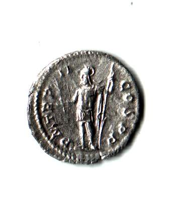

                      • Very first find, done by V3.1 today!
                        Wow!
                        • Along with this denarius i also discovered 20 more bronze coins too.
                          But those are very low quality, not worth to mention them...
