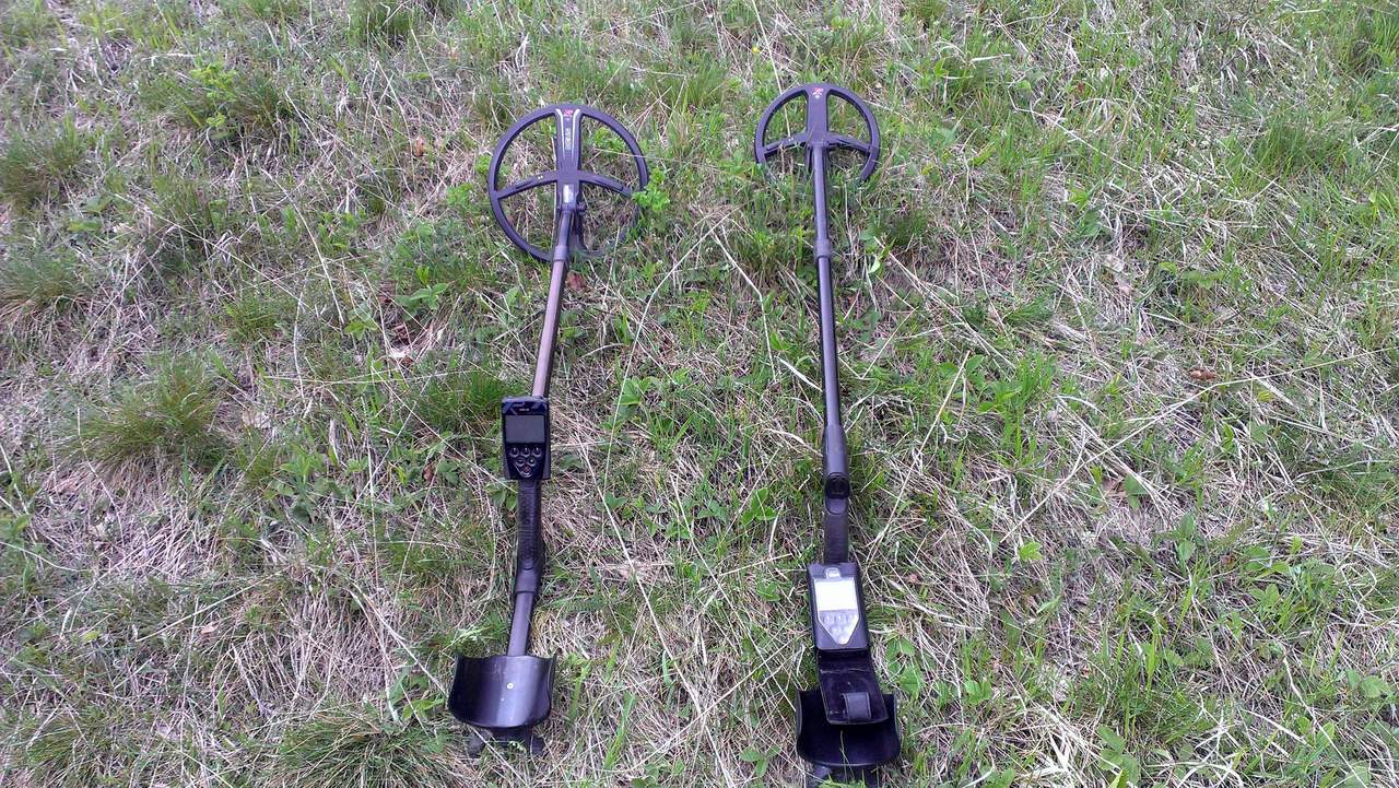

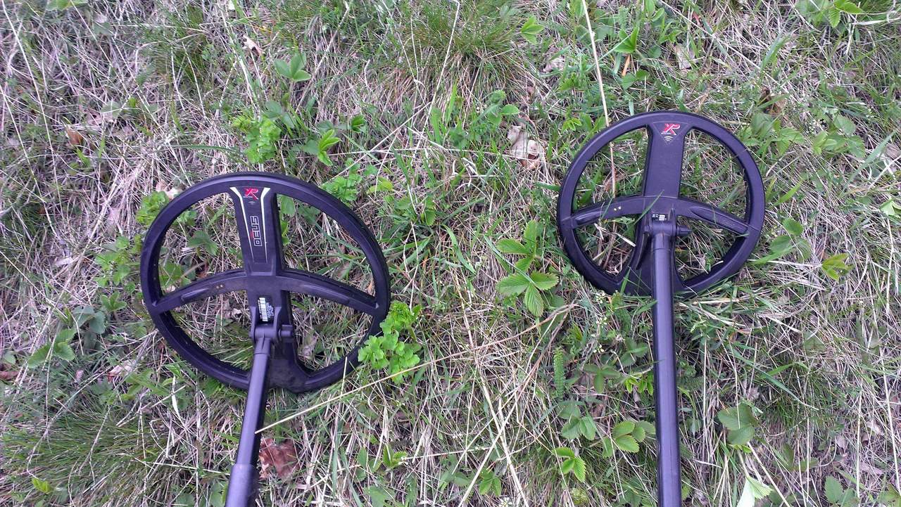

                      • New day... new coil!
                          Hope on first impressions tomorrow.
                            First impressions: it is indeed lightweight, it is obviously deeper than smaller coil.
                            Didn't checked if it is deeper than larger coil too.
                            Stormy weather outside, i must delay detailed tests
