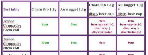

                      And if one is not familiar with B. Candy theory, here a small excerpt from practical test (test targets as on picture in post #23):
