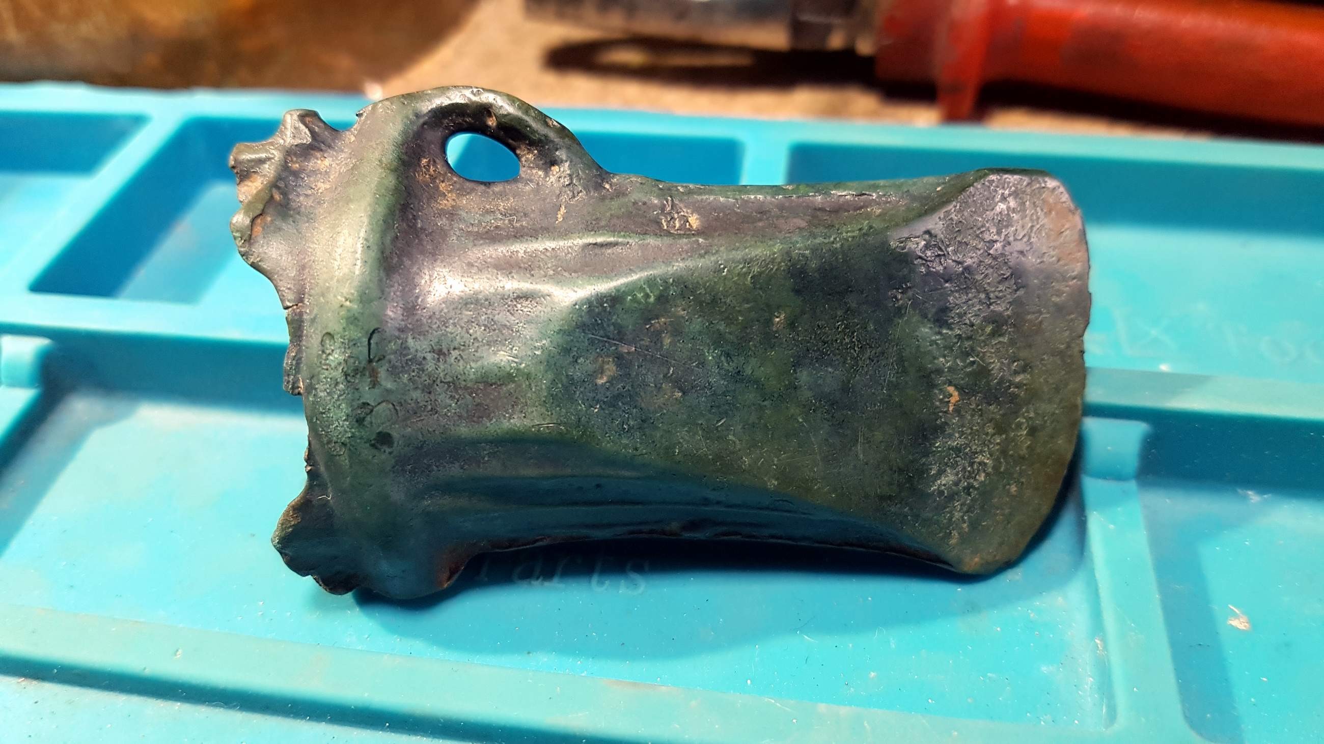

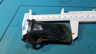

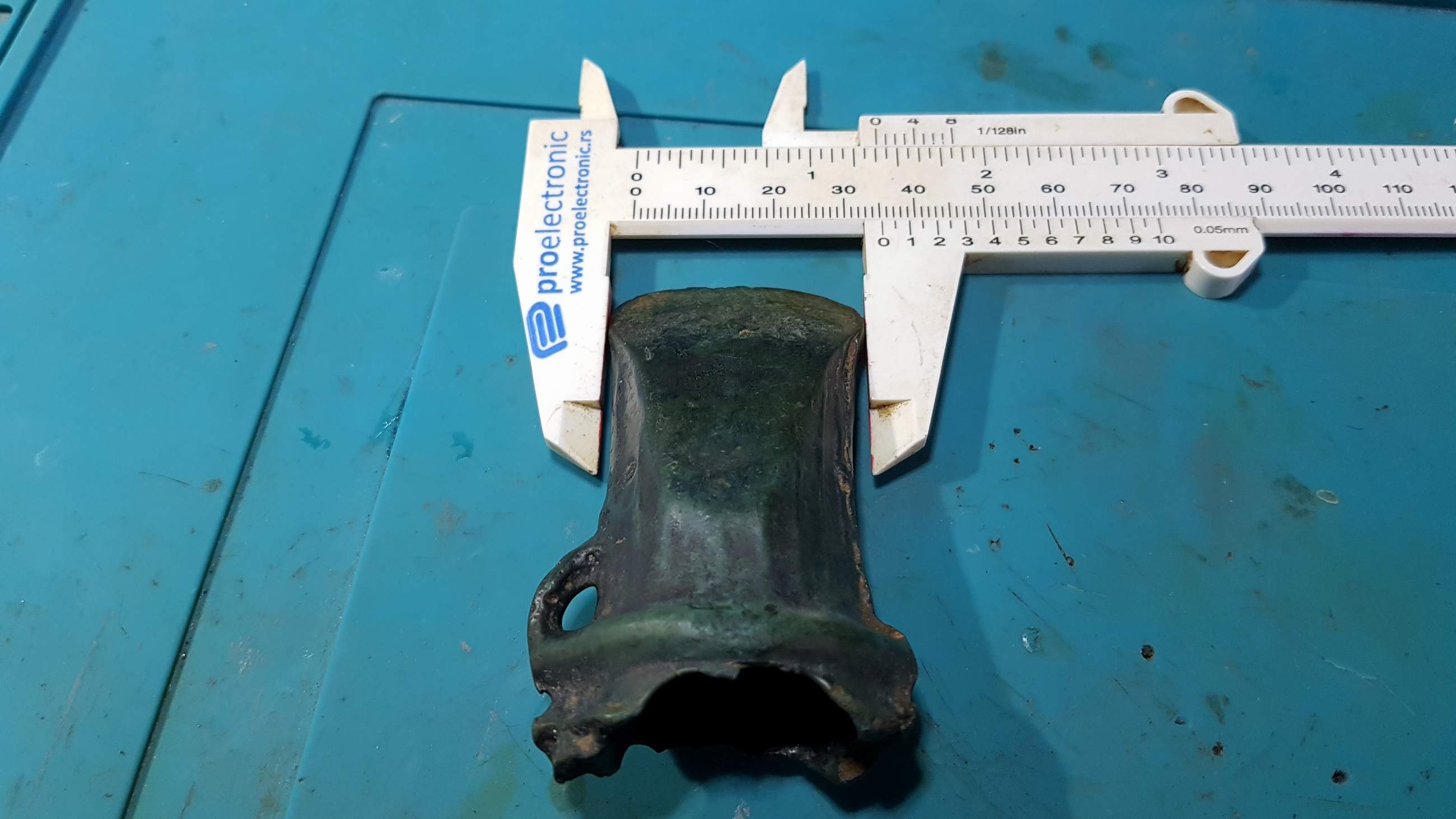

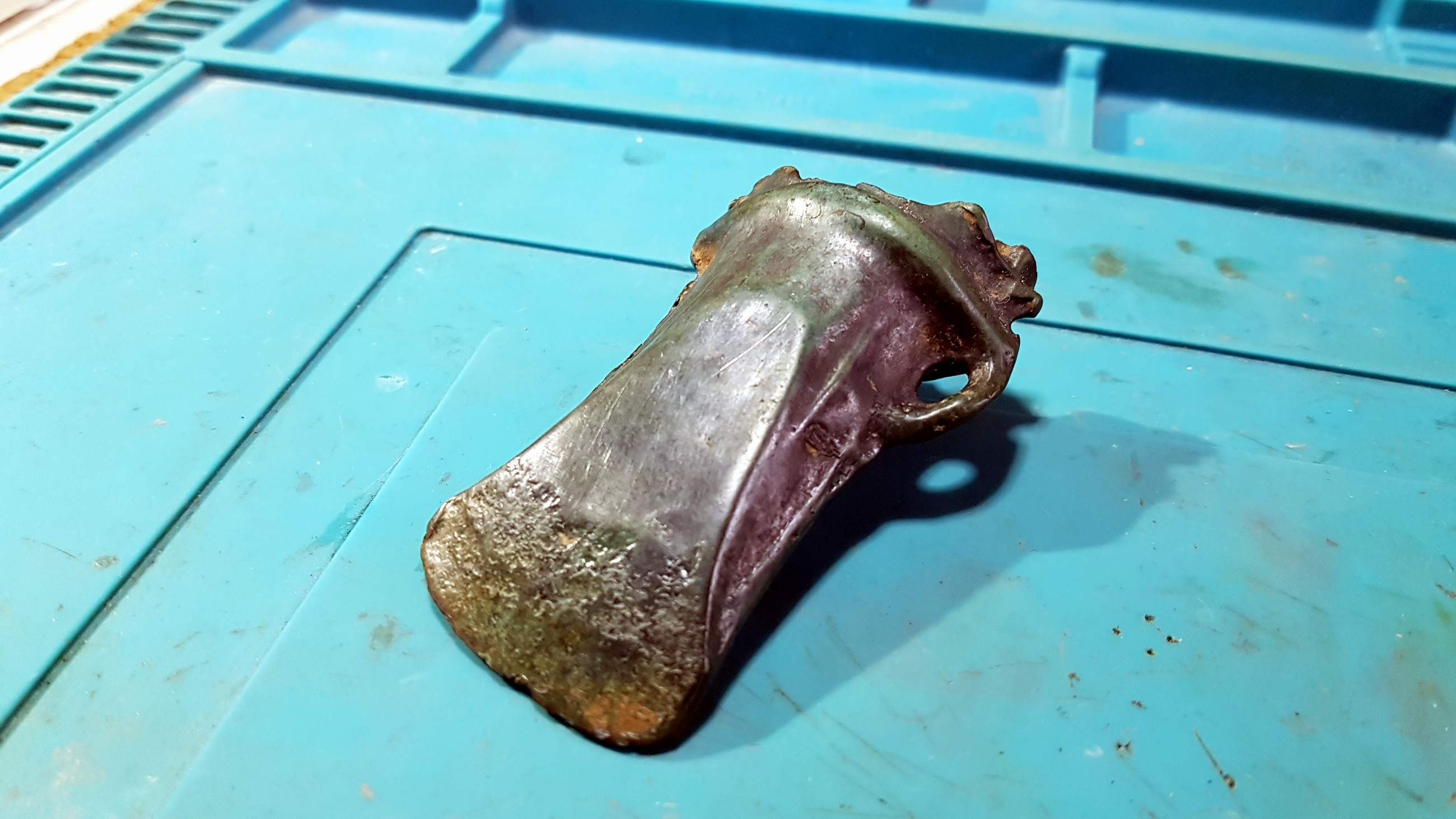

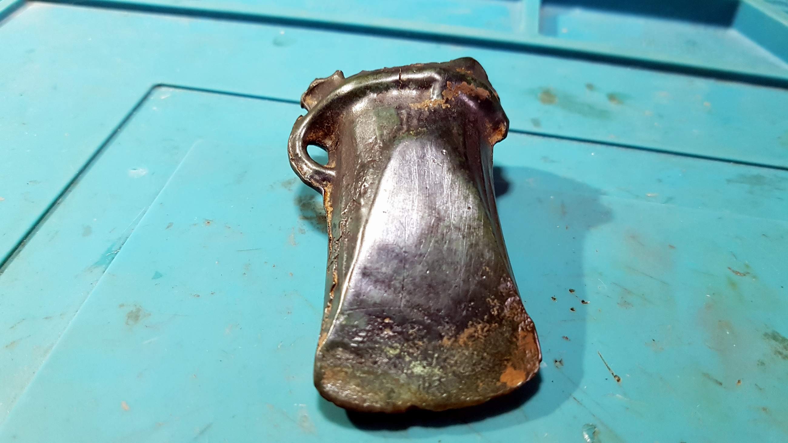

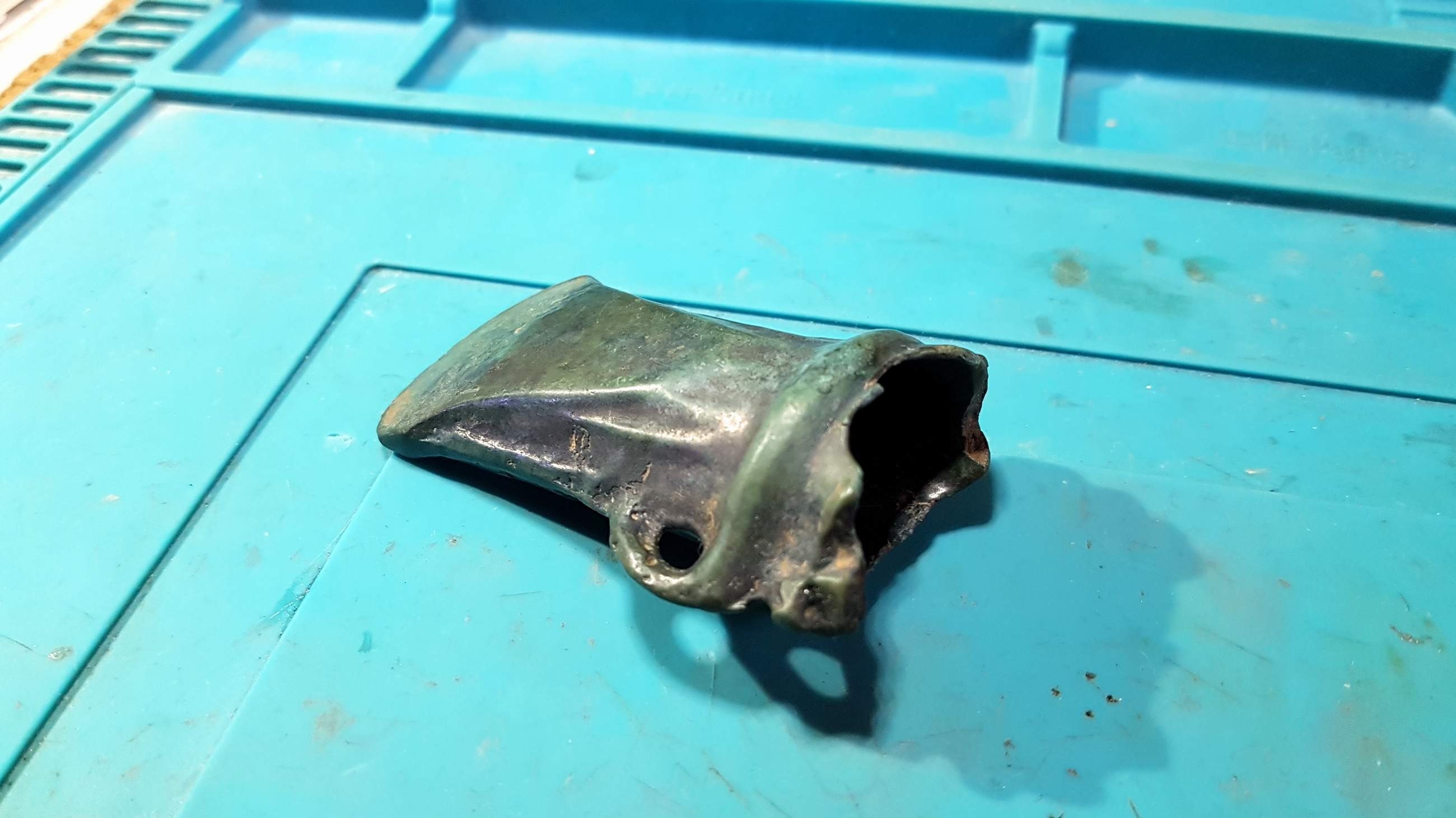

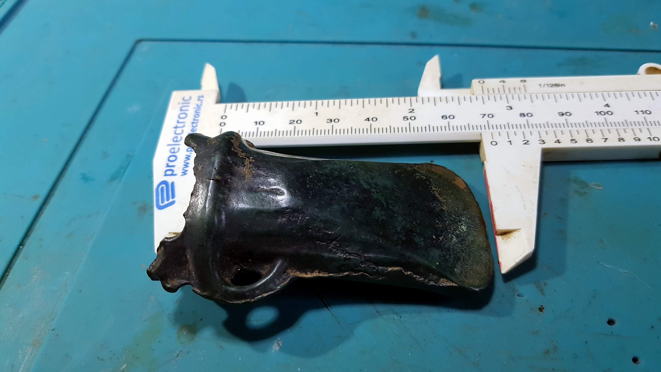

                • ~3000 years ago someone lost this:

                        • Originally posted by pito View Post
                          who found it, you or the dog ?
                          Deus!

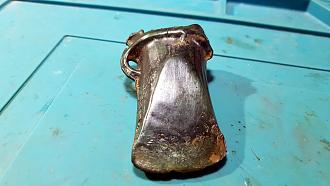

                          • I used to go out 150-200 days a year on the sites.
                            Since covid year, I started going out less and less (nothing to do with covid, pure coincidence) and the time has come when I am happy if I go out at least 20 times a year.
                            I went out today for the second time this year. And finally a "premium" find!
                            200m in the hill above my house...
                            I have 6 cats in my house, but they hate to keep me company in such undertakings, they rather stay asleep, but that's why "Djodja"
                            (female, 10 years old) is "faithful as a dog", reliable and persistent to keep me company all the time.
                            At the beginning of the video it looks like she sneezes, no it's not a sneeze, it means "ACTION" in dog language!

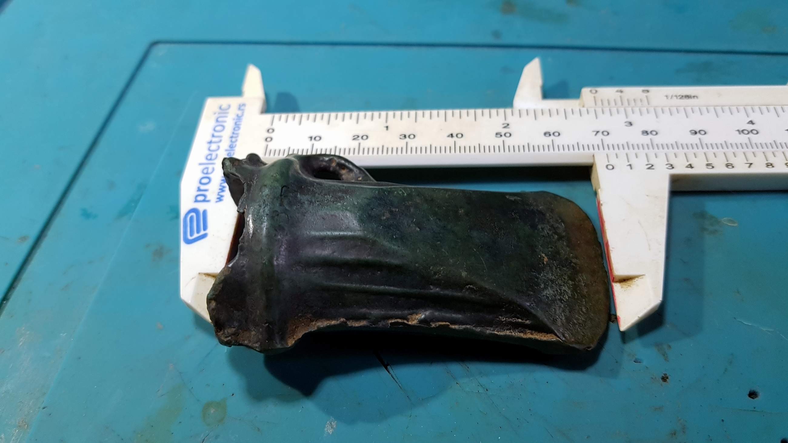

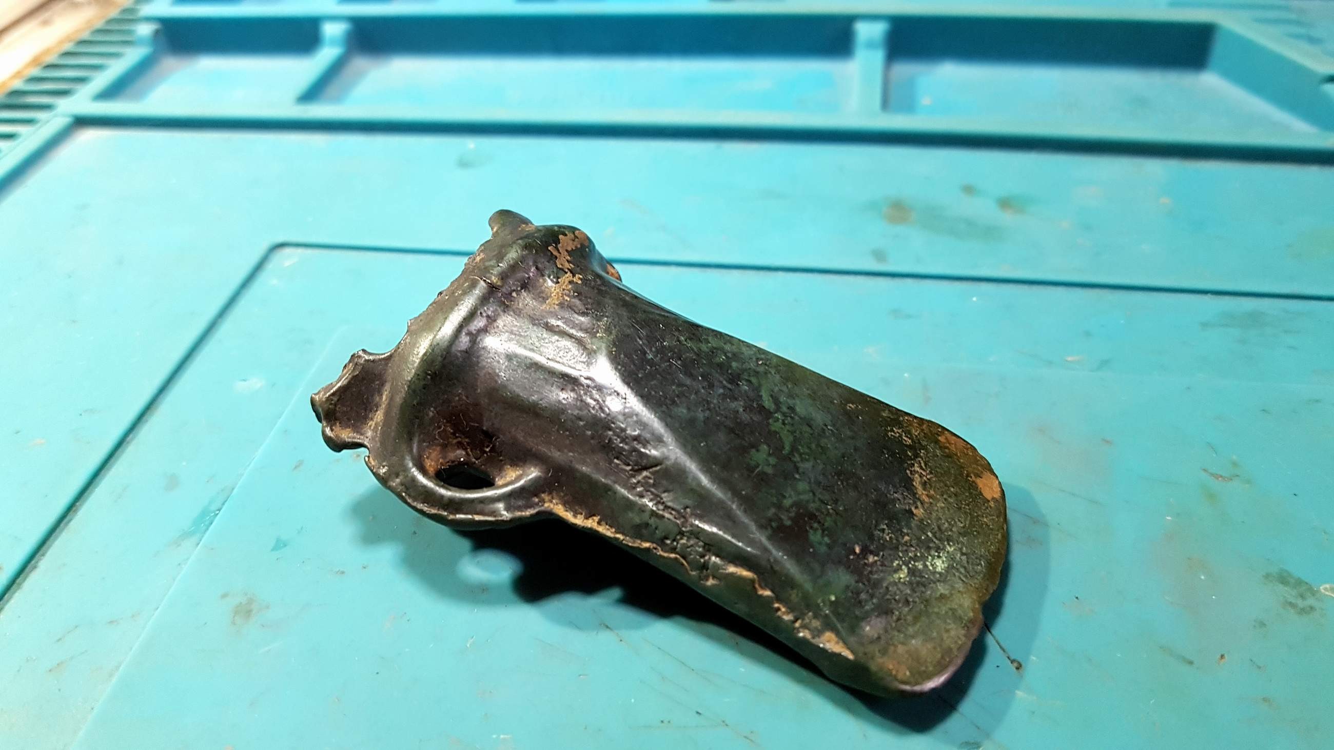

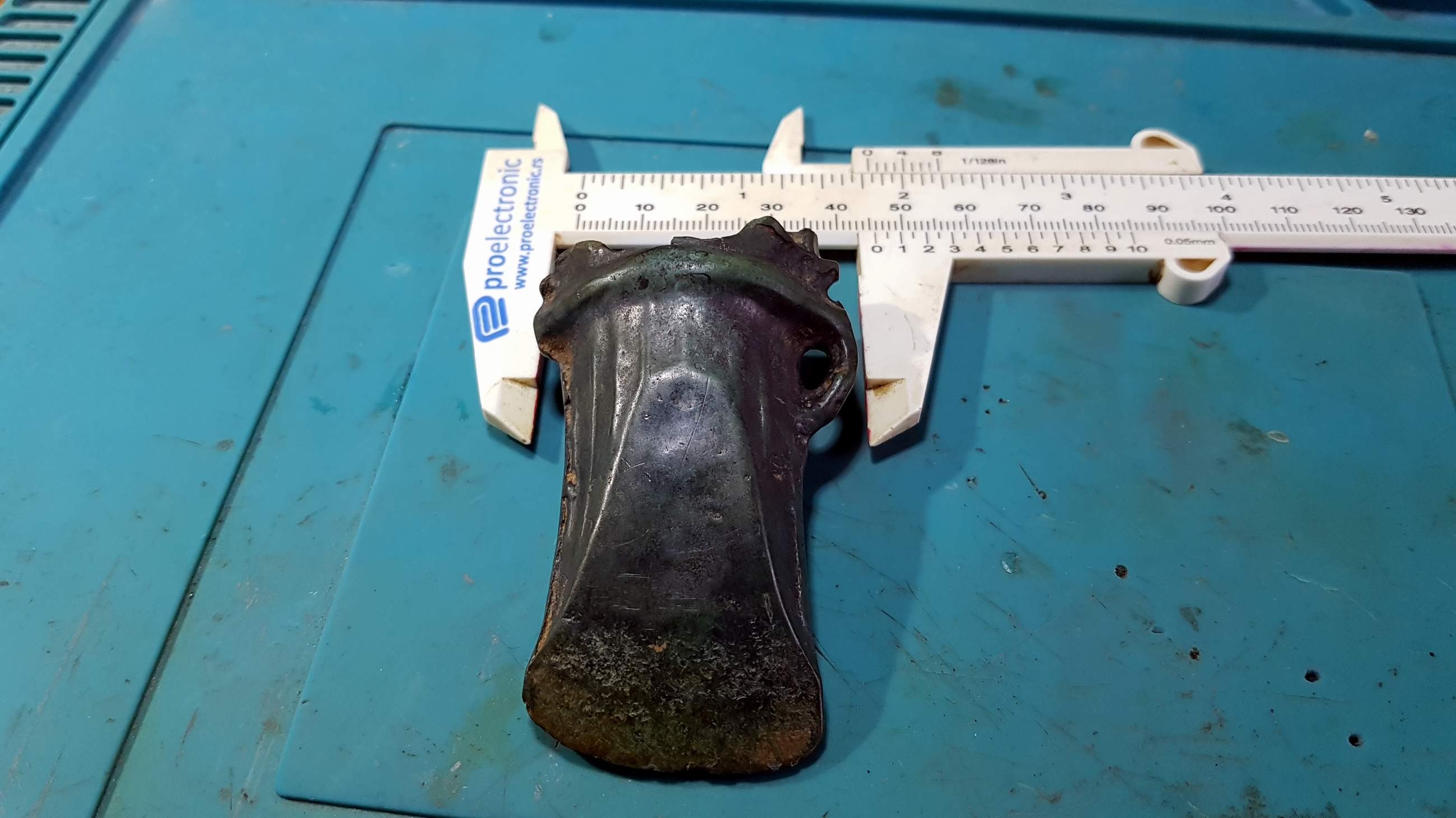

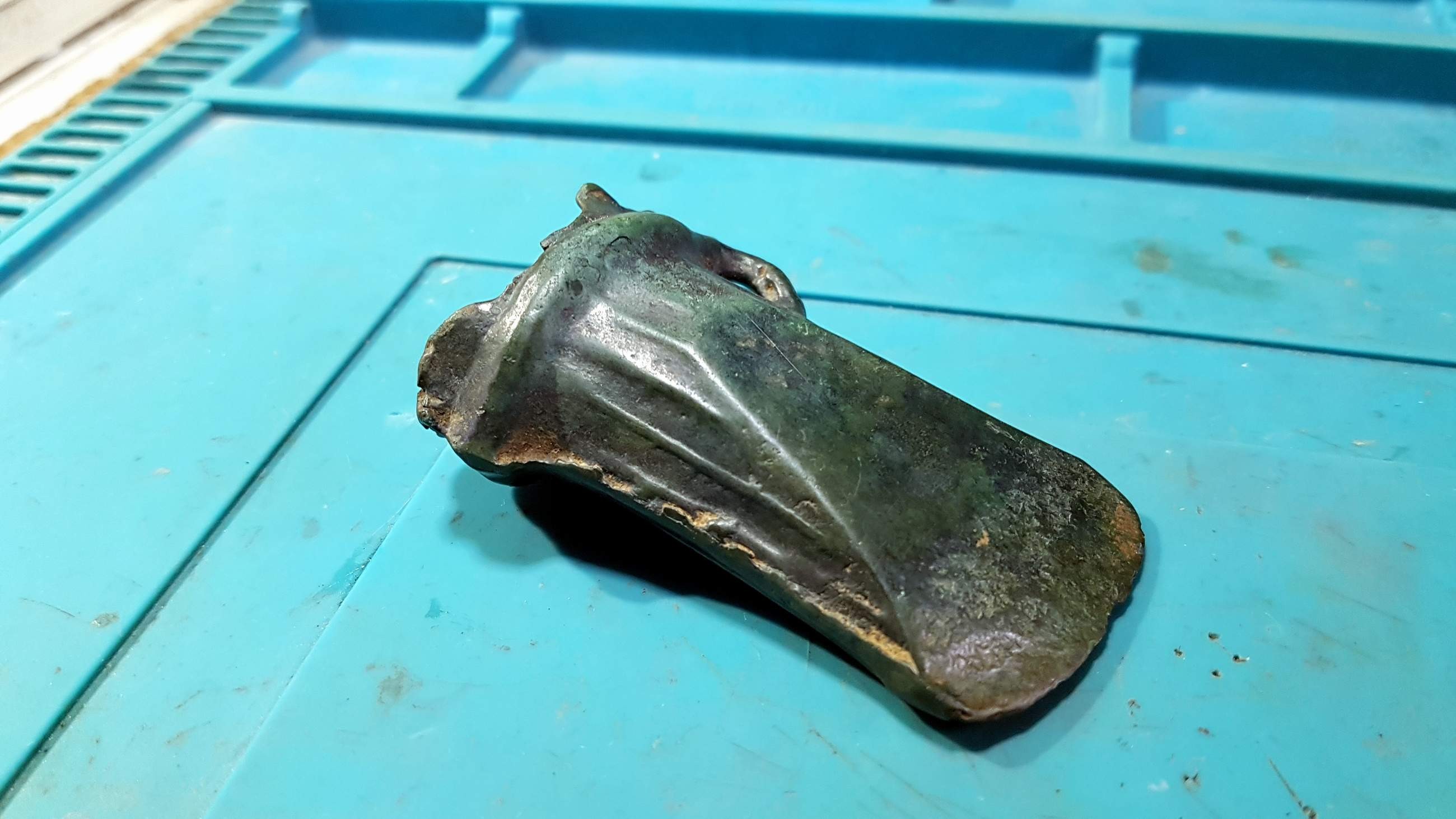

                            • I received confirmation from a professional from the museum that this is a bronze "axe" from the 10th-11th century BC.
                              I will enjoy it for a few days and then it goes to the museum.
                              • It's a fabulous find! Really very interesting. The museum is the right place to put it. Thanks for sharing your discovery.
