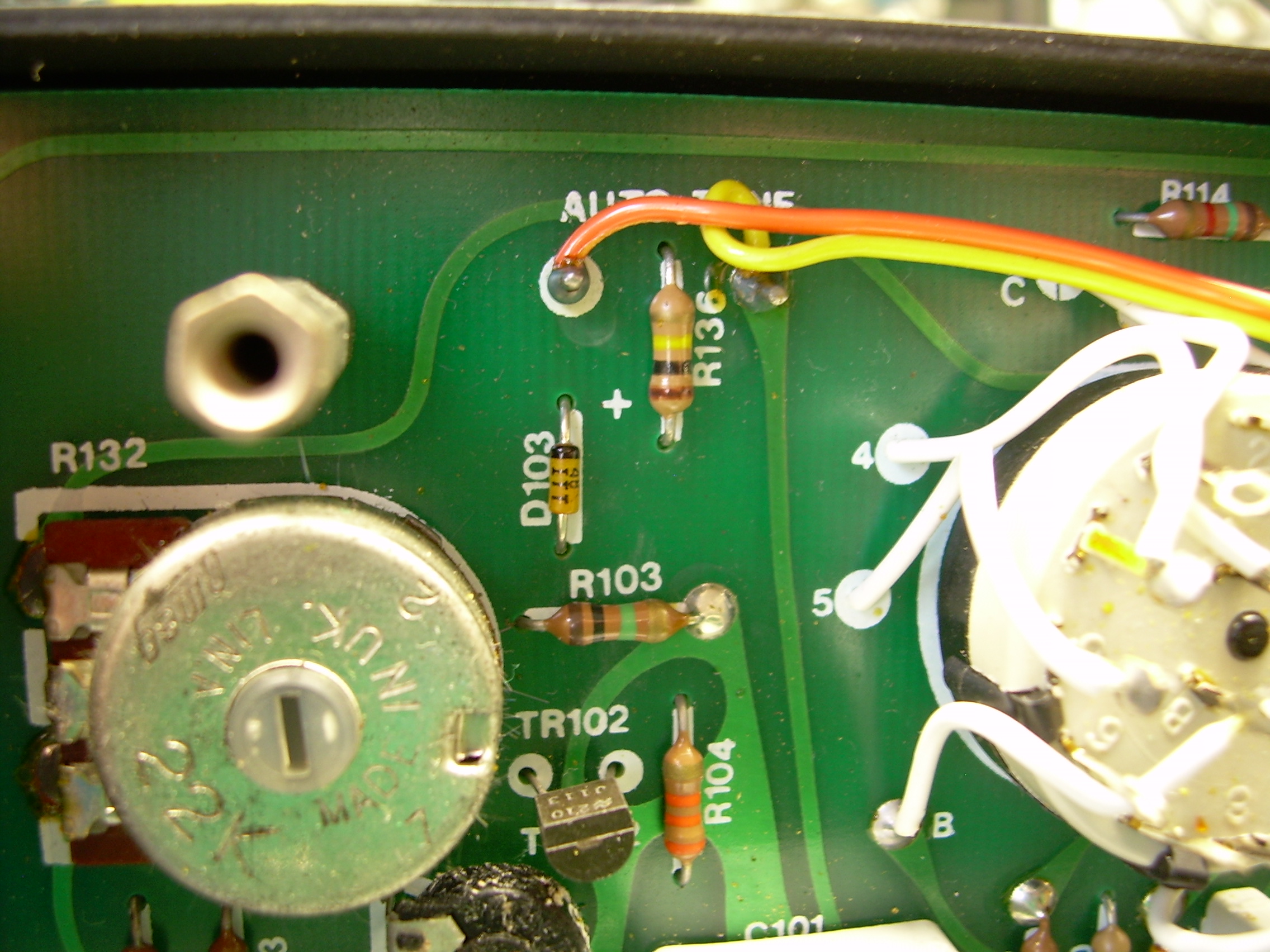

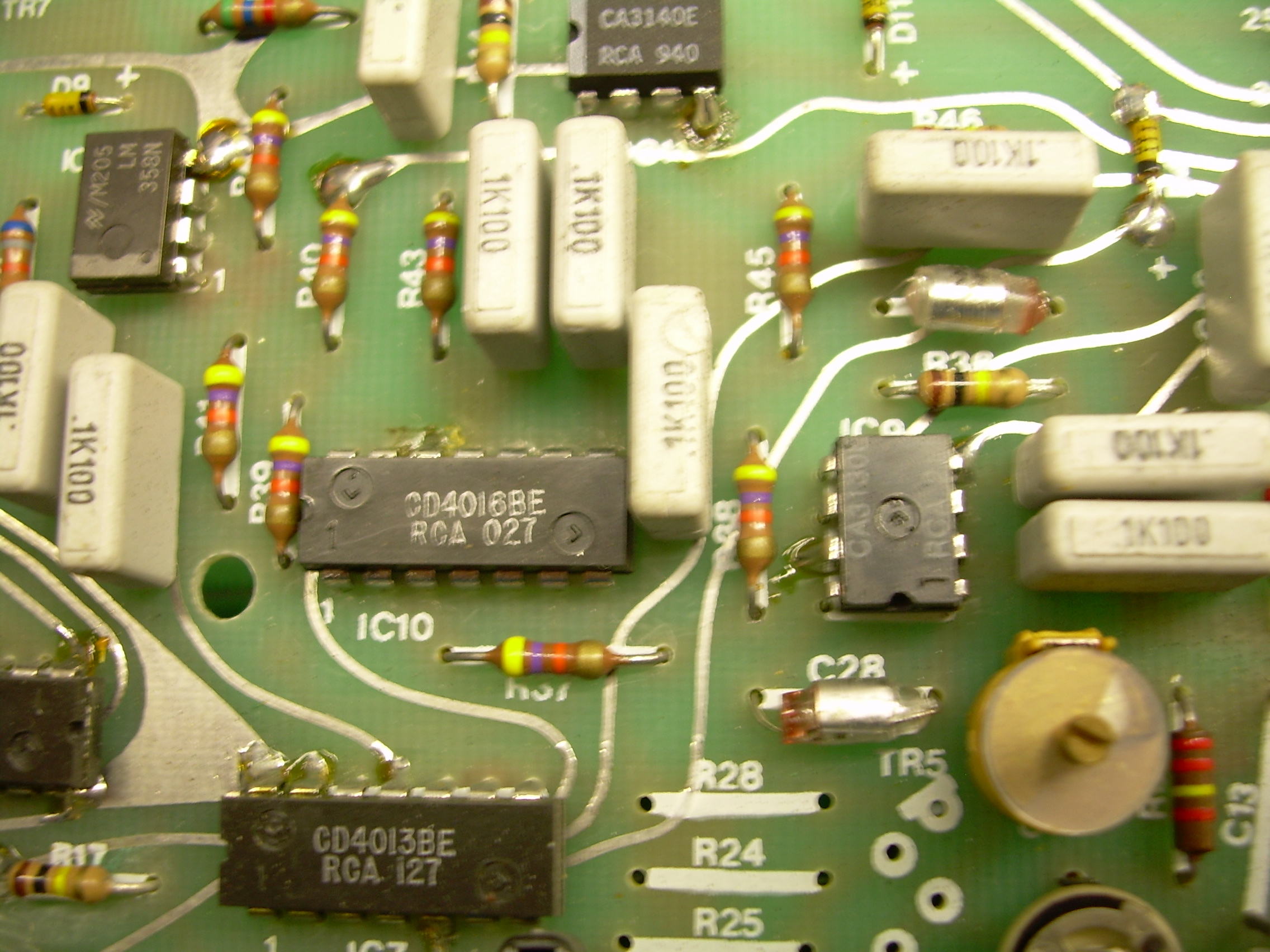

    i go to buy the capacitor for my cscope but no body know what is they.in picture c28 what kind of?what is the voltage and value?50HY27 write on this
    thanks
    ANd anothe is the teransistor
    number TR102.
    thanks
      TR102 is a FET switch J113, and the capacitor is a foil wound one somewhere about ~100pF
      Both seem to be in perfect order ?!

        ok now1- i need to Equivalent of them?
        2-how you certain Values of the capacitor.can you tell me what are 150HY40 and 1000HY47 and 3nc R4ks and 20HY32 ?

          The capacitors are measurable, you just have to yank them out an measure. Only if they are burnt and obviously damaged you guestimate. What are you actually trying to achieve?

              Some capacitors have their value in pF followed by some combination of odd letters and numbers that may have some meaning to the factory that makes them, but are generally useless to the rest of us. The insulating material in the capacitors is responsible for their voltage rating and their temperature coefficient, but good luck finding what is what.

                  Observing those few pictures you posted I can't seem to find anything wrong. Unlike you, Guzzi posted lots of pictures, while your links lead to some odd Iranian pages with no content related to your detector, so I wonder ... are you for real, or you are just pulling my leg?!?
                  If you are for real, then you'll post a real description of your rig condition, whether you obtained it broken, or it broke in meantime, what happened when it broke, does it do anything, and if it does what it exactly is, and so on.
                  From the Guzzi's pictures, not yours, but Guzzi's, I can tell the detector was in it's youth about 1982, which gives it some 30 years of service ... what kind of service? Blazing sun or damp rain? Not used at all?
                  Those 2 pictures you actually posted show no problem at all! The upper side looks good. Nothing burnt. So problem can't be something that generally does not make trouble. So picking random parts will not lead you anywhere.

                          I apload my picture but yet I and my friend Alain have problem about the capacitor.please help.in my country have not j113 ?????????what am i do?I search about Equivalent but it have one Equivalent and the name is BSj113(the book name is A to Z)

                              There are some physical limitations to the capacitors production, so 1000uF can be only an electrolyte. A designation without pF or uF can also be in pF, so 1000pF is a fair guess for a small non-electrolyte capacitor.
                              As for J113, your best bet is finding another FET with similar Idso and I'd suggest BF245A, but I have no idea if those are available to you. What are the common types there? European, Russian, Japanese, or else?
