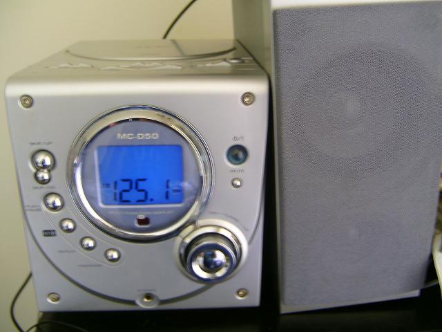

    Got bored of listening to FM Radio....So what do you do with a Teac Stereo with Digital FM tuner?
    Convert it to the Airband and listen to local aircraft.
    This model is the MC-D50 and tunes from 95-125.2 Mhz now and is spot on frequency and no drift.
    I think the Tuner goes up to 199 Mhz but i need to rebuild the Inductance coil in the LC circuit to achieve higher VHF frequencies and make it possible to listen in on Amateur Radio 2 meters 144-148 Mhz.
    A slight adjustment to the demod allows AM modulation to be heard intelligently.
    125.1 Mhz is my local active Aircraft Tower Frequency.
    Cheers Sid
