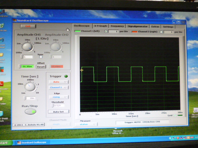

    For some time I have been interested to see if any of the FREE sound card PC based oscilloscope programs were of any use to fault find on low PPS PI detectors IE: Surf PI.
    I made the recommended probe for the Scope Program ver 1.4 and tested it on a simple 555 @3 volts running at 137 PPS.
    The program started and after a bit of a fiddle with some of the settings to see what they did, and selected LINE IN, in settings,
    I connected up the probe to the sound card, and put my finger on the end of the probe, and there was a 50hz wave form.
    On to the 555, I was very nervous connecting the probe to a 3 volt circuit as I did not want to damage the sound card, and made sure the clipping diodes worked, but it works.
    In the picture you can see the wave form from the 555, single channel, its not perfect , has a little wobble, but may be usefull for somebody that only has a multimeter for testing.
    One good thing in FREQUENCY mode the program showed a PPS of 137, which matched the frequency counter on my two digital
    multimeter's .
    Program was running on a 3.2ghz p4 with Windows XP. http://www.zeitnitz.de/Christian/scope_en
    I am trying to get over a virus right now, but my intention is when I get a bit better, I intend to do some comparisons between my real CRO and the PC based oscilloscope.

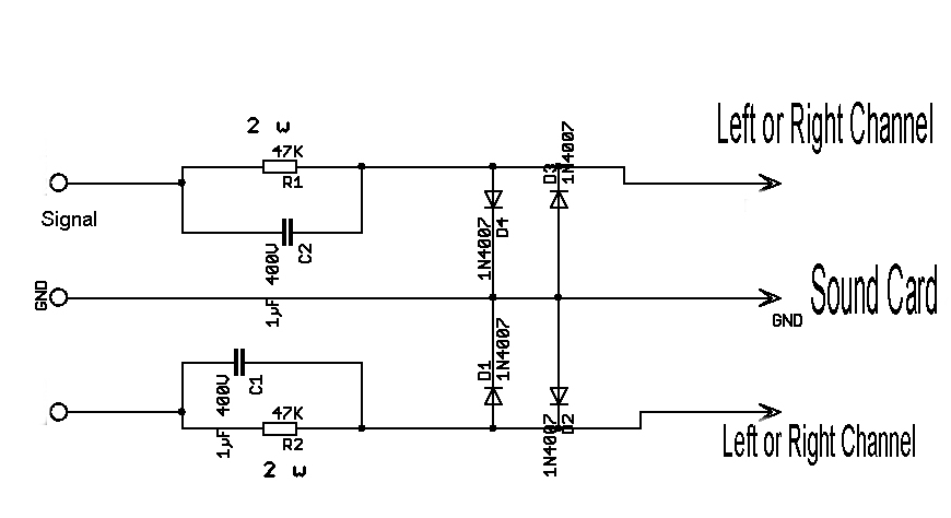

    This is the recommended probe .
    I mounted it into a diecast box with BNC connector to attach a real CRO probe
    and shielded cable to the sound card.

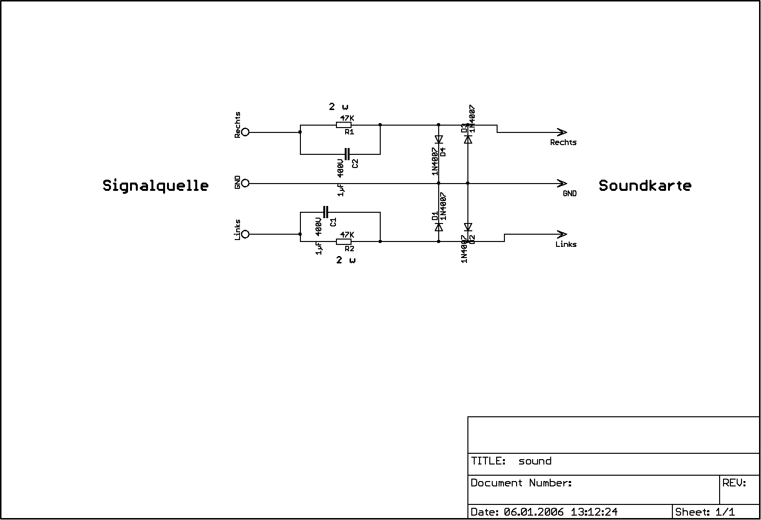

                On the connection you have line in top and gnd middle, where does the links connection go at the bottom?
                  Hi Dave
                  one is left channel and the other right channel.

                          hi i downloaded the program and worked fine but still i have to build the probes can i use co-ax cable and solder in c/p with other components as here will not find probes. can you state the voltage and frequency range .
                          thanks
                            Both depend upon your sound card. Real probe is needed in case you need to measure some high voltages, or at high impedances, but otherwise you can use a simple coax and you can even solder it in situ.
                            You can do most measurements this way. I did it with IGSL and a laptop last summer and it certainly works. I even balanced a coil that way. Provided you know what you do...
                              hi all and that is interesting am looking for a scope and will try this for the idx-pro from Silverdog will use pcb and solder comp hi 6666 you use a 2 w resistor why ? am looking also for an inductance meter?? thanks
