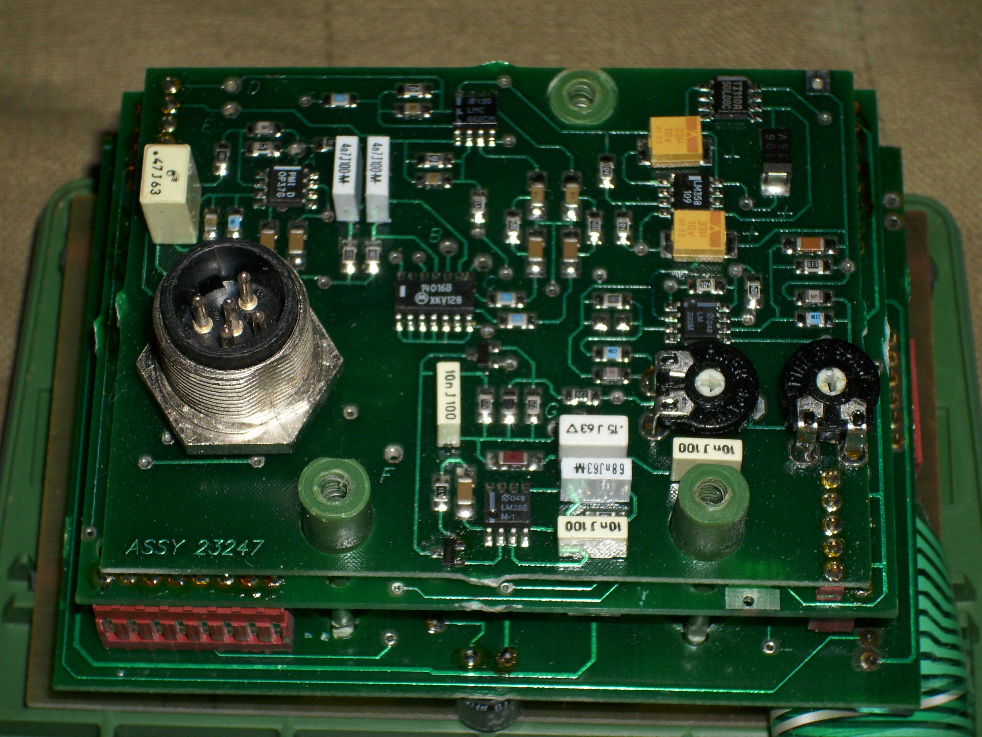

    Hello ,Hello, I was given an old garrett gta 500, I notice two pot on the bottom pcb, apparently one is the ground ballancing against the other I do not know what it is, can you tell me say if you know what it is. thank you

    They are for ground balance and disc calibrate. They go to a LM393 comparator which controls the phase of the demodulators
    Almost all the coin detectors use this scheme.
      OK thank you, I set it in the ground effect quite easily but the other how do I go about to set?
        The other you would adjust by watching the LCD. A 1oz silver coin would indicate to the far right icon. Aluminum foil would read under
        that icon. Iron would read to the far left icon.
          ok, thank you for these explanations to this setting should I put in A or B?
            I have no idea what A and B are? Its been about 15 years since I held a GTA500. I would use A since that is probably "normal"?
