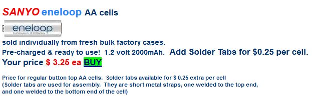

        Well....crap....that's a shame....OK.....you get to saw the pack apart(use a hacksaw).....along its edge. Go slowly & carefully to preserve the pack halves.....especially that connector on the end. I'm guessing your pack is tapped....that is more than one voltage is coming out of the pack. Observe the wiring & polarity of the connections. There could be as many as 4 electrical connections on that connector. Notice the size of the cells.....I'm guessing they're likely AA size solder tab NICD type. You want to go for NIMH type. Go to this site and see what you can find.

ID:	336827 These are the best.....they're expensive...but they will hold their charge....that is they won't self discharge as rapidly as NIMH types.

            Here is what you need 10AA nimh series connected. Then you need to solder a barrel connector to the leads. I also have a 17000 that needs a battery and your post reminded me to get one. If you are interested pm me and I will order two and attach the connectors.
