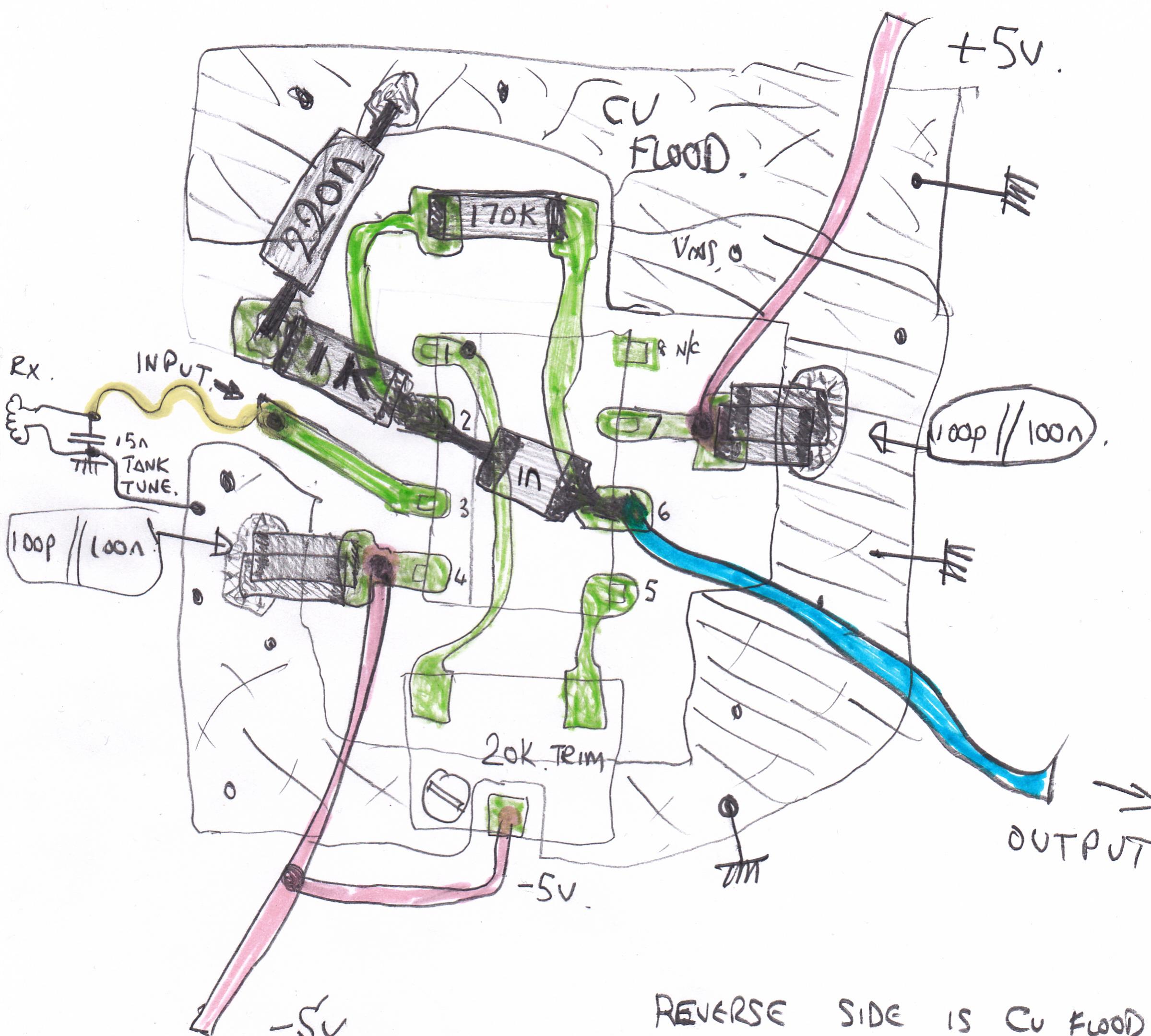

    Im trying one - just for fun. I am not having any success in making it work. Tried some old chips and thought they were broken, splashed on a new one it too isnt working for me.
    I dont get any output from the op amp unless I have v large input signal (volts) from a huge lump of iron - then I get rail to rail output squared off. Another odd thing is, as I reducenthe signal in, the output DC level flips to the positive rail an stays there?
    where Im at..
    Im using a double sided board with copper flood on reverse and a bit on top with vias thru - attempt for solid ground work
    Decoupling 100p and 100nF right on the pos and neg rails.
    Ive got a 20k pot to null the offset - but o/p still sits at -3.5v and pot doesnt move this?
    I put a couple of diodes in the gnd lead of the 8v reg to jack it - I have +5 and -5v rails.
    If I disconnect my coil - my machine beeps all the time, I can see a oscillation on 797 output, it has approx square wave with some RF - which I like because it shows the amp is working and I expect this performance with unterminated pin 3 (input)
    Any clue what to try next - I need to get cracking on a farm, so if I cant use this amp Ill rip it off and go back to original.

      Don't know, I've used a 797 before with no problems.
        Can you post your schematic, and perhaps a photo of your physical layout?
        The op amp has input protection, but if it has railed the input protection diodes and input stage itself might have been affected if there have been no input current limiting means. Damaged op amps can (and usually will) behave in curious ways. With high GBW/slew-rate parts it's necessary to keep the layout very clean and have stable power supplies.

                Is there a chance I bought the wrong amp as there is 2 types of 797.
                I got the cheaper one -ARZ which appears to have the hotter BW and may explain my fail?
                  cant take picture of layout, drwg instead

                    Got this reply from AD ..
                    "Steve,
                    This is central applications for the Americas. I have copied central apps for Europe above.
                    They should be able to assist you.
                    However, I would point out that the thermal noise of a 170k resistor is 52 nV/rt-Hz, so the 0.9 nV/rt-Hz of the AD797 is wasted.
                    Also, input bias current of the AD797 is about 1 uA, so you have about 170 mV of induced offset. The input voltage range and
                    output swing only gets within 3-4V of either rail, so the AD797 is not really meant to run on +/-5V, but rather +/-15V. Finally,
                    The AD797 has a huge amount of gain at high frequencies, so you need a four layer board and two bypass caps on each
                    supply as described in the apps section. Maybe an ADA4841-1, ADA4004-1, OP37 or AD8671 would be better.
                    Also see AN-940.
                    Harry
                    S
                      You might wish to slash the resistances of 1k and 170k to 1/10 of their current value (this should take care of noise and offset), and place something like a 3k3 or 10k resistor between pins 2 and 3 (often helps at switch-on, and in absence of source impedance). Also you may consider something like 100ohm between pin6 and everything else (which helps coping with uncooperative loads)
