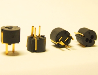

                Hi Mohandes, you need to put transistor socket in PCB and test different model version and brand of FETs without desoldering it, cause it is easy destroyable by soldering.
                Like this:
                  Like this:
                  [ATTACH]26566[/ATTACH]
                  thanks but i should be use this in my country

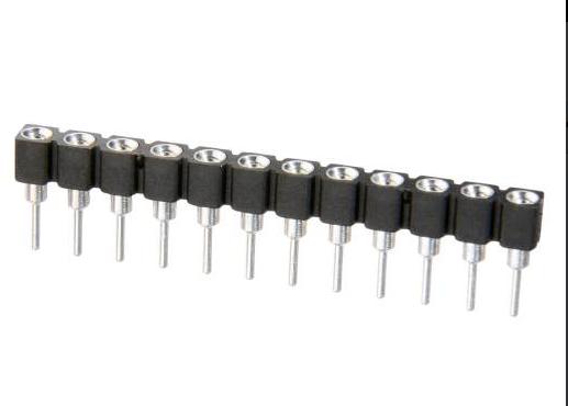

                    Yes, or this easily breakable:
Name:	single in line socked.jpg
                      wm6 can you post a link to were you found those transistor sockets I been looking for them
                        You have a lot of those stuf on eBay. You need to search on eBay using words "transistor socket" or for those posted in last my post search words "single inline socket".
