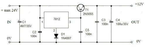

need +12V regulator
  • need +12V regulator
    hi
    i need schematic for +12v regulator .
    i want use this for DP2 , so any one an help me ????????
    how about a LM7812?
      I'm using it.
        use impulse STEP-UP DC-DC 5-35V output converter. I buy them on ebay for low price. they are PERFECT for DP and any VLF.

        ... I took ones on LM7522 based... this is something not on this IC... STEP-UP is PROTECTING your electronics ITSELF,
        because output voltage will be NOT OVER than input in case if the converter would burnt.
        Specifications:
        • Input voltage:3.5V-32V
        • Output voltage:5V-35V
        • Input current:Rated current is 2.5A,maximum 3A(Additional heatsink is required)
        • Load regulation:±0.5%
        • Voltage regulation:±0.5%
        • Work temperature:-40 ℃ - +125 ℃
        • dimension:42mm*22mm*14mm(L*W*G)
        • NOTE:This can't be used to step down Voltage

          thanks man.
          it is good choice , just i want know how current DP2 use when connect 1*1m coil and DEPTH volume in max ???

            it is good but when i use lithium battery (14.8 v , 2.2ampere) , the start current an not produce .so i should use 2number of 12v ,0.8ampere parallel for your circuit . if you have idea i listen .
            Excuse for my English
              14.8V 2.4A (4 cell) I am using for lipo battery. I have not encountered any problems

                dear KT i buy it .
                if i use 2.8AH ,12volt battery ,can work by 1.1m*1.1m coil 8 or 10hour ?
                  10 hour you will dig 3-4 meters holes? your name is Scwartzenegger? superman eah? 2-3 hours is your physical resource, no more!
