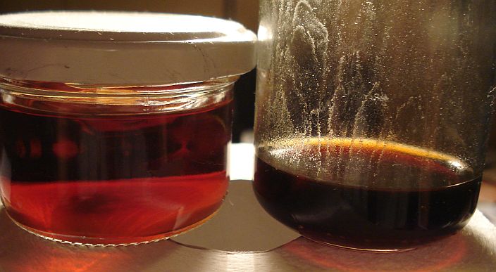

      Anyway, I found a nice link on the internet on how to DIY fluxer.
      Take the old hard and dry pieces of pine tree sap, scrape/break it off with a knife. Don't worry about pieces of bark or dirt sticking in it.
      Fresh sap doesn't seem to work as well, I don't know why.
      Dissolve the pieces/scrapings in either Ethyl Alcohol or Acetone. This can take a few days. Swirl occasionly. Use a jar that you can throw away for this.
      Then take a cloth (I used loosely woven linen) to filter it into the jars you will store it in. Don't try cleaning the cloth either!
      You can adjust the viscosity by letting the solvent evaporate accordingly.
      I prefer Ethyl Alcohol, as I find it has a much nicer smell and won't dissolve any plastics I use.
      The left jar is with Ethyl Alc. the right one with acetone (which has already evaporated a lot through the lid).
      I use it for tinning stripped and often corroded wires in a solder bath.
      I really enjoyed this DIY, especially the simplicity of it and the quality of the fluxer is superb.
      Enjoy!
