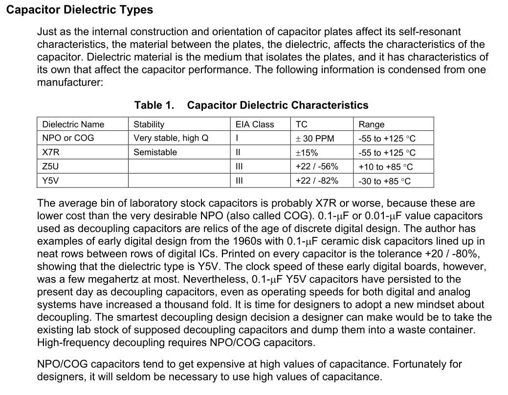

    I found this whilst wondering and looking into the capacitors I would use in the Nupi pinpointer.
    I thought caps were simple passive components and have come to realize that a project can
    rise/fall with the right/wrong choice of capacitor. Thought I would share this.
    Found in:
    How (Not) to Decouple High-Speed Operational Amplifiers - Texas Instruments
    www.ti.com/lit/an/sloa069/sloa069.pdf
