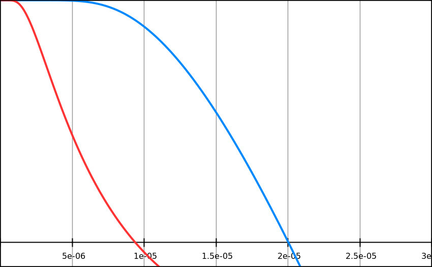

            Zero spot of my method compared with the delayed sample method.
            Let's assume a Tx pulse is 50us long (T1) and the target is sampled at 8us (t0).
            My method:
            We add a second measurement period T2 = 400us (long pulse).
            8us after the short pulse T0 the target signal s0 is:
            which varies depending on tau.
            and 8us after the long pulse T1 the target signal s1 is:
            applying the ground elimination formula we get:
            The attenuation of the ground-eliminated signal relative to the original signal is:
            Delayed sample method:
            We define t1 as the time when the ground signal has decayed to 50% of the value at t0. This is obtained by solving t i the following equation:
            which gives t1 = 14.4 us.
            applying the delayed sample we get:
            Where K = 1/0.5 = 2, now the attenuation is the following:
            Comparison:
            Blue line: my method with T1 = 50us, T2 = 400 us, t0 = 8us and k= 1.14
            Red line: delayed sample method with t1 = 14.4 us and k=2.
            My method has a much larger bandwith, it seems.
