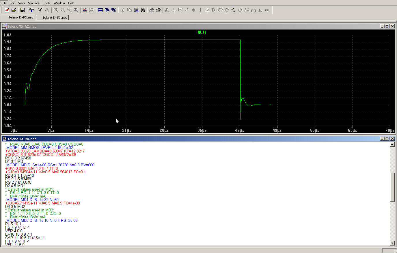

    Can someone point me to a thread where this matter is discussed?
    I'm simulating a PI with two coils and damping seems impossible. Even at low R's.
    Tx coil: 40uH, 0.8ohm, 40pF, 1.9A, theroretical damping resistor: 500ohm
    Rx coil: 160uH, 1.6ohm, 80pF, theroretical damping resistor: 700ohm
    Target: 0.333uH, 0.333ohm (1us tau).
    Coupling coefficients:
    Tx/Rx: 0.9
    target/TX & target/Rx: 0.01
    Current in Tx coil looks awful:
    any pointers on this?

    Just looking at the same problem with a real coil TX and separate RX assembly.
    TX coil self resonant frequency = 1.04MHz
    RX coil self resonant frequency = 1.400MHz
    So the next thing I will do is to see if making the 2 coils of the same Tau makes a difference.
      I guess I've figured out why virtually all PI designs are monocoil.
      Perhaps a differential RX coil arrangement wiil do. Anyway my ngspice chokes on it.

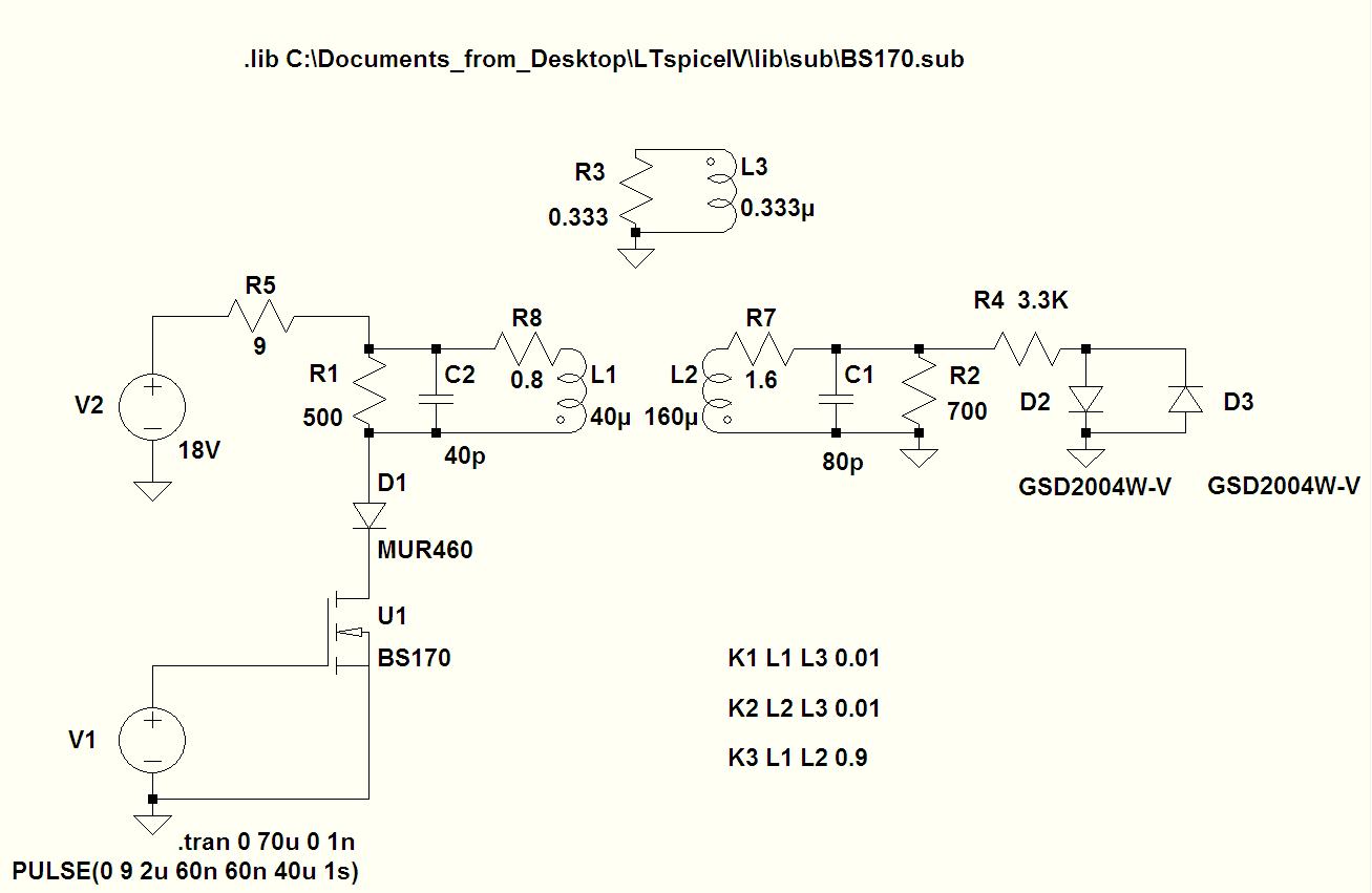

        Perhaps you could show your schematic so that we can see what's going on? You mentioned Rx to Tx coupling of 0.9? That's a lot. Most arrangements are induction balanced and coupling is well under 0.1
          I'm not sure I've ever simulated a 2-coil PI, but they're easy to build. I'll go with Davor, your coupling is too high, although I've also built a highly coupled TX/RX coil and it worked fine.
            This is my simulation circuit:

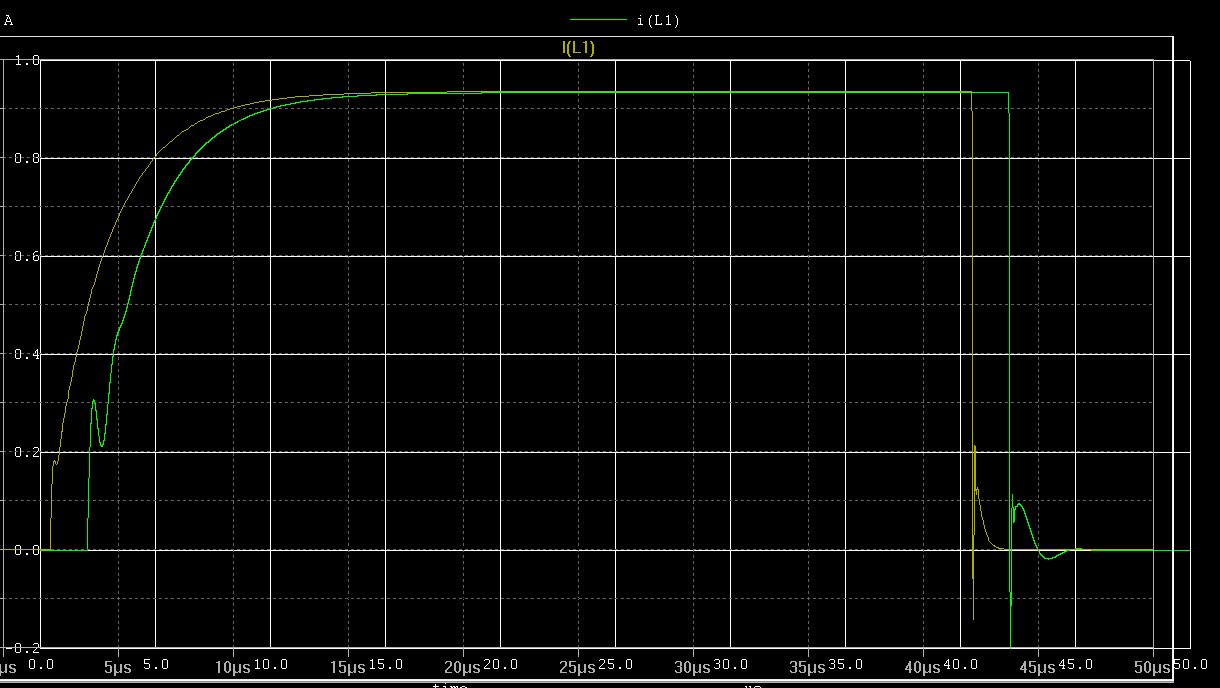

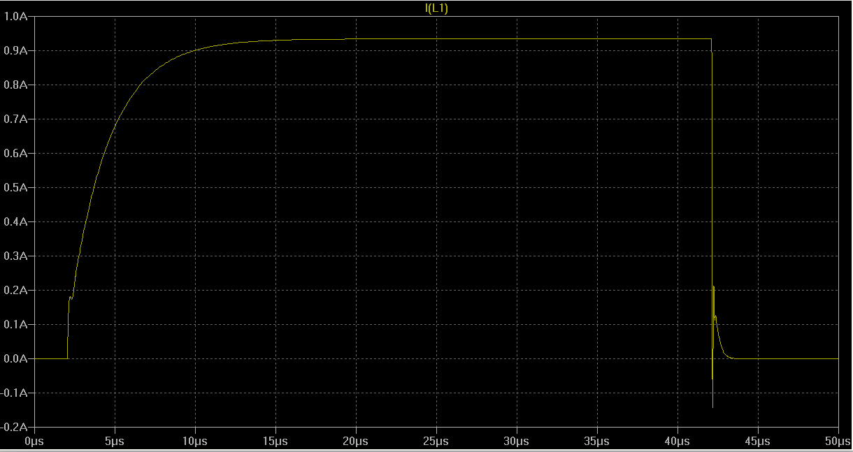

            There are significant differences between ngspice and LTspice simulations even though the components are the same. I have no idea why.
            For example, see the different currents in the Tx coils (green: ngspice, yellow: LTspice), ngspice is seen more capacitance ????
            Timing is the same, just skewed the signals to better see the the differences.

            K1 L1 L3 0.01
            K2 L2 L3 0.01
            K3 L1 L2 0.9
            .end

              You must a small difference in the circuit that was entered in LTSpice, as I've just run your NGSpice netlist directly in LTSpice (after adding the missing .tran statement) and the results look exactly the same.
                Thanks! ngspice doesn't understand some parameters in the MUR460 and GSD2004WV LTspice models, that must be it.
