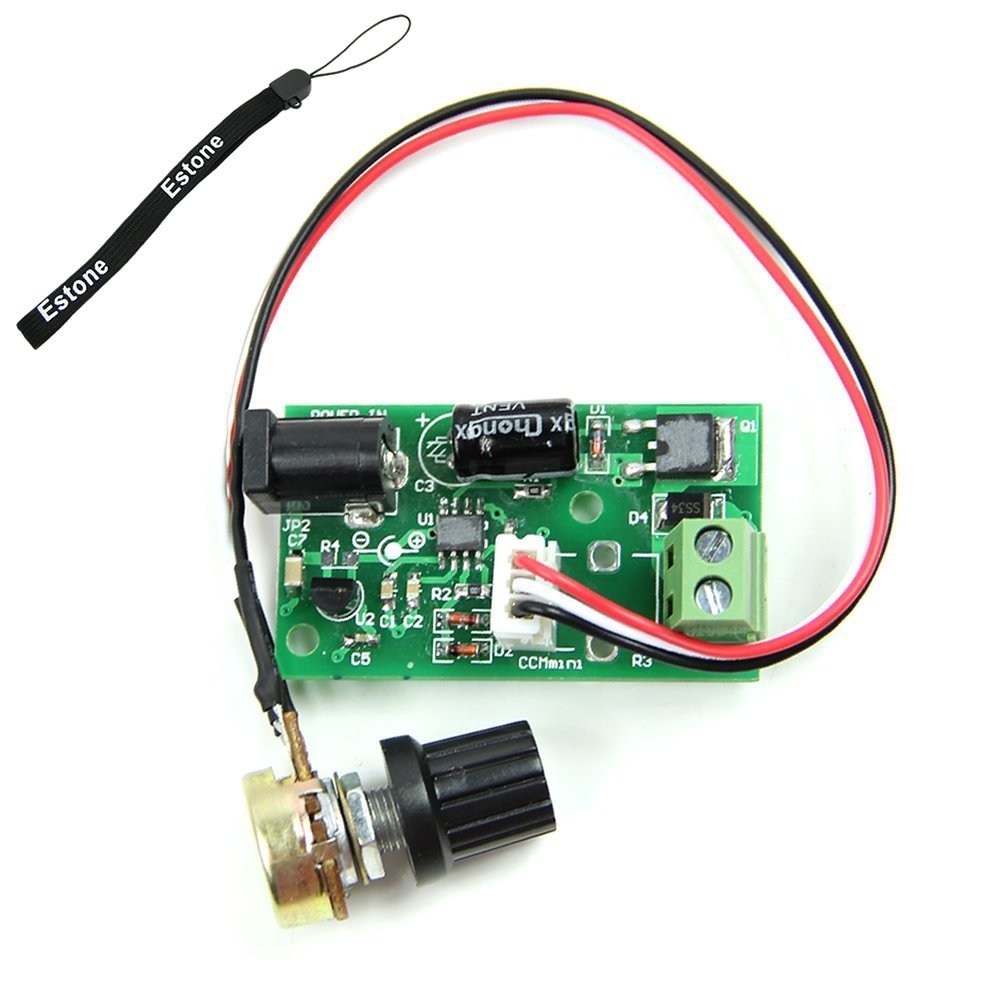

    I'm thinking of making a DIY fume-extractor for soldering electronic components to the circuit board. I like the idea of being able to vary the fan speed. This would allow me to set the speed for best draw of fumes into the carbon-activated filter chamber.
    What electrical considerations do I need to know to properly match a speed-control device and a small fan ?

      I might be stumped, too. Is it an AC or DC fan? They are controlled in entirely different ways.
        AC fan, buy a light dimmer. DC fan http://www.eleccircuit.com/simple-va...for-beginners/ or
        http://www.eleccircuit.com/regulator...nsistor-c1061/
          ToddB66, I have used this type of device a few times to control the speed of a 12v DC computer fan... they work well and control the fan speed with no hunting of the motor...
          http://www.ebay.com.au/itm/181539908750
          For AU$3.20 I feel it is not worth stuffing around to build something.

            I'm thinking of using an AC to DC 12 Volt output Adapter, to power a recycled DC computer cooling fan.
            ToddB66
              A PWM controller like G-set suggested is probably what you want.

                  I went to the e-Bay address hyperlinked in G-set's post #5, but there is a note that indicates the item is not posted to the U.S.
                  (see note copied & pasted below.)
                  Posts to: Australia, Americas, Europe, Asia
                  So I was able to find a similar PWM speed control at Amazon.com and ordered that one. See the attached photo and ad below.

                  Estone Hi-Q Pulse Width PWM DC Motor Speed Regulator Controller Switch 6V 12V 24V 3A
                  Price: $4.69 & FREE Shipping
                  In Stock.
                  Ships from and sold by heroneo.
                  Estimated Delivery Date: Jan. 21 - Feb. 6 when you choose Standard at checkout.
                  • Control the speed of a DC motor with this controller.
                  • High efficiency, high torque, low heat generating.
                  • With reverse polarity protection, high current protection.
                  • Model: CCM mini
                  • Input voltage: DC6V - 28V
                    Good stuff Todd, that PWM controller will do the job very well.

                          I've seen that before and decided to build something larger with a carbon filter and variable-speed device purchased on Amazon (Estone Hi-Q Pulse Width PWM DC Motor Speed Regulator Controller Switch 6V 12V 24V 3A, sold by heroneo, new condition). When purchased it was $4.69 with Free S&H. I'm waiting for it to arrive this month and I've attached a photo below. BTW, noticed I made an error in my previous post #9, Dec. 25, 2014, when typing the max-end of the Voltage range as being 28V; this should have been 24V.
