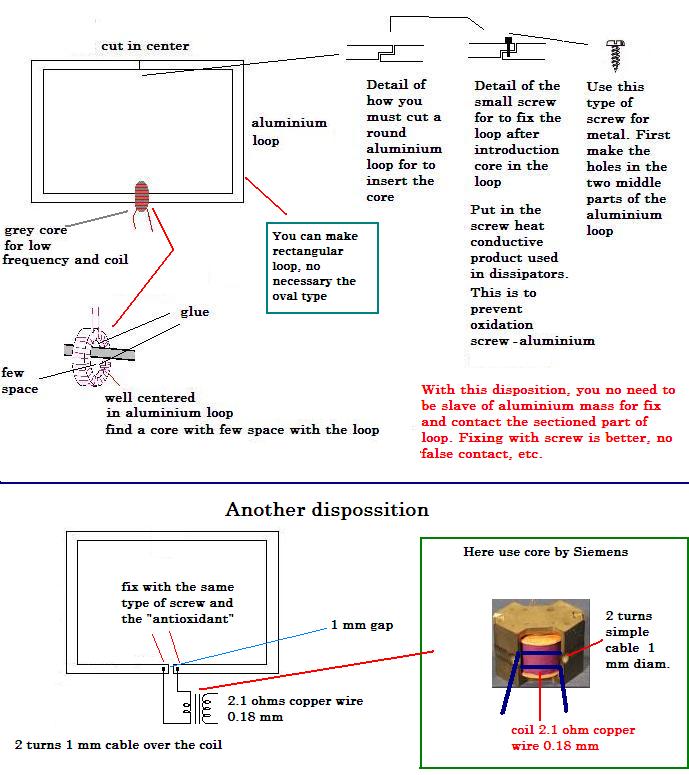

        Is this any use?
          Thank you, my friend, for your interest in the subject, and actually this scheme may very benefit me in the draft, thank you my friend
