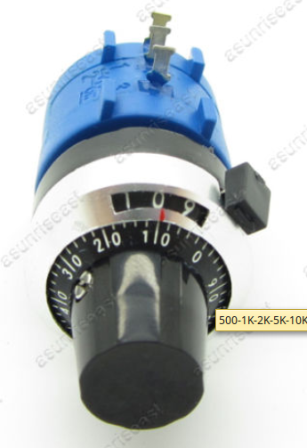

    Hi all. I want to maximise the available adjustment of the threshold pot. What I would like to know is it possible to have two pots in series. One to get the adjustment close and the other for finer tweaking. If it is possible what would you recommend the values of each should be. Thanks.
    10 turn pot
    Find them on ebay.

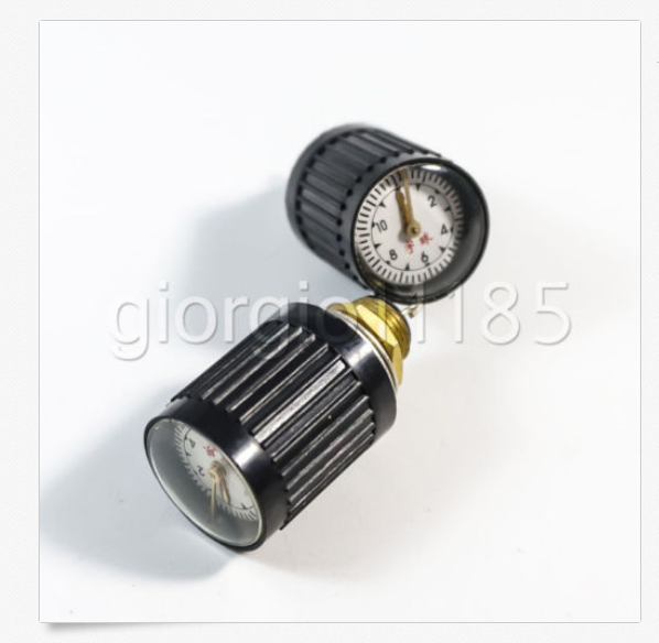

    I use the one that looks like a clock, works excellent to change PI frequency. If they don't have to be waterproof.

      I like that clock pot.
        Thanks Sven. Do like the look of the clock pot.

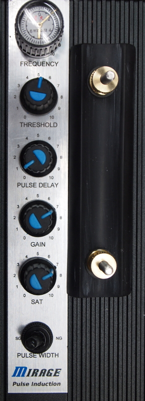

Name:	top plate.JPG
            Hi Sven
            i was looking at your top plate...how did you do those decals so good ???
              Demo version http://www.abacom-online.de/uk/html/demoversionen.html
                did you print onto clear film then put on top of control box ????
                  I used a silver colored mylar polyester decal sheet made to be used in Laser printers.
                  Offering laser & inkjet label sheets / printer labels by the sheet or in bulk. Most orders for blank sheet labels ship same day. Buy what you need, buy online. Perfect fast solution for small business, home office, special project, product labeling and more. Located in Illinois.
                  Set the printer to transparency print mode. Fuses the toner hotter so it can't be scratched off.
                  Or you can take the front panel file after you export it to a .bmp, jpg to a local printer that prints decals.
