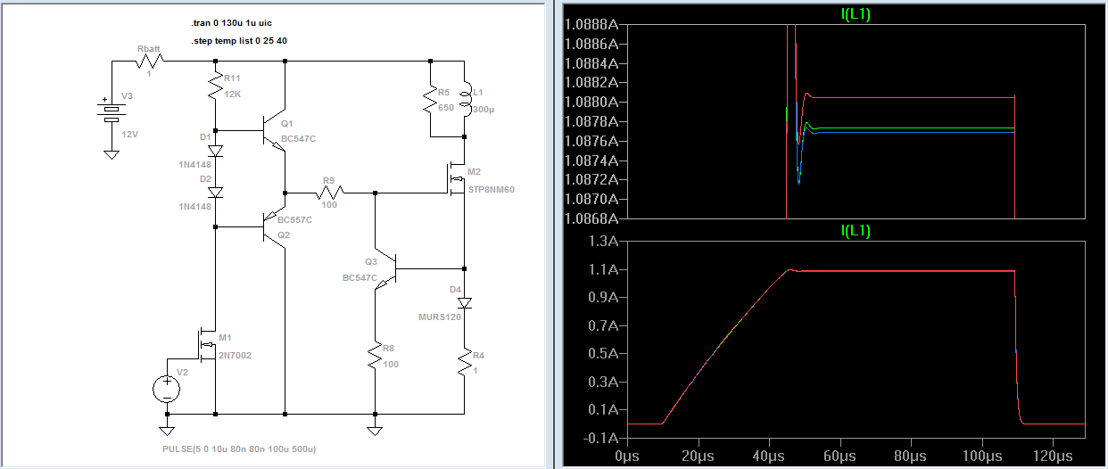

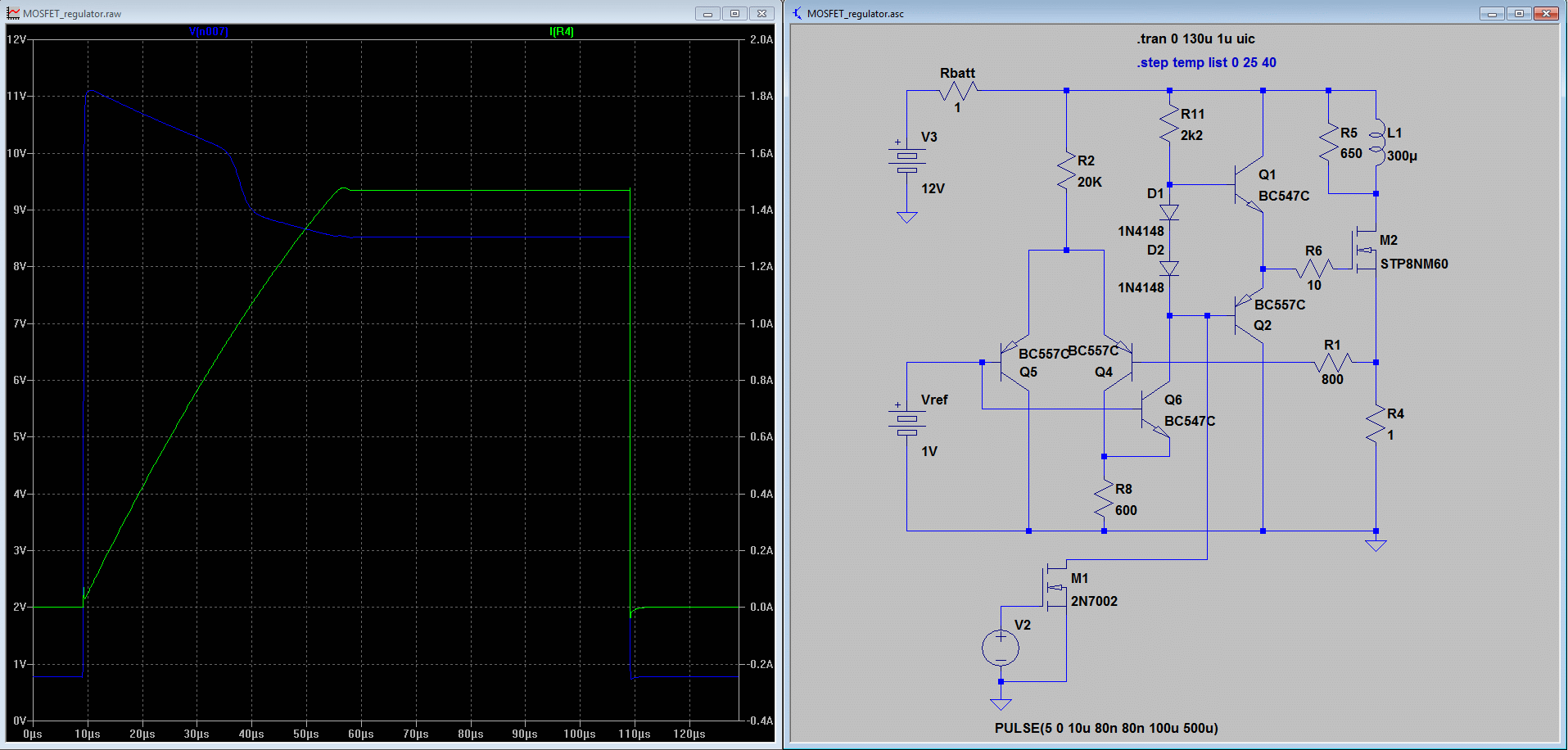

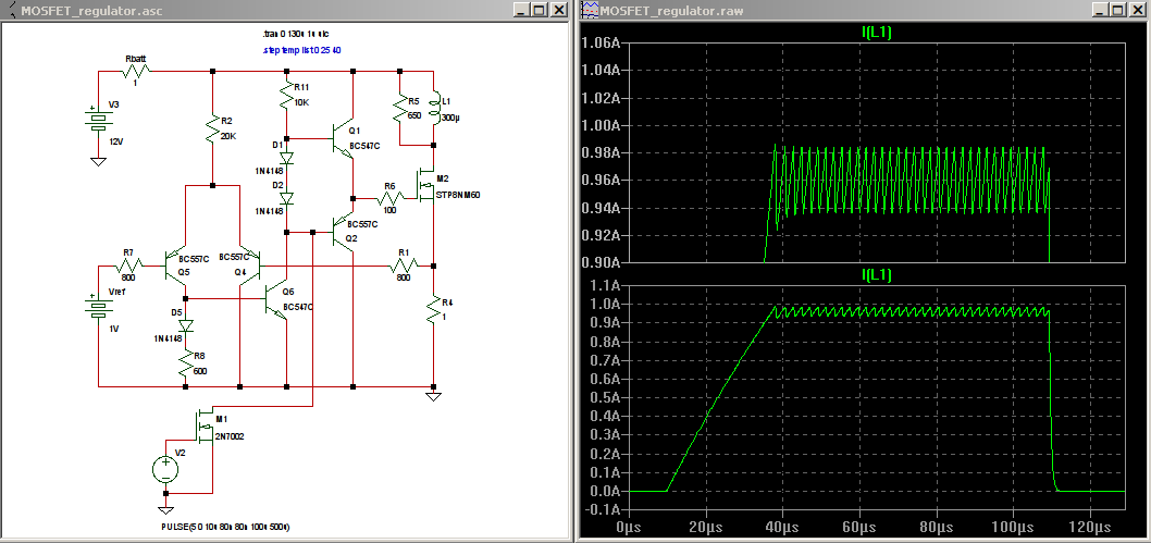

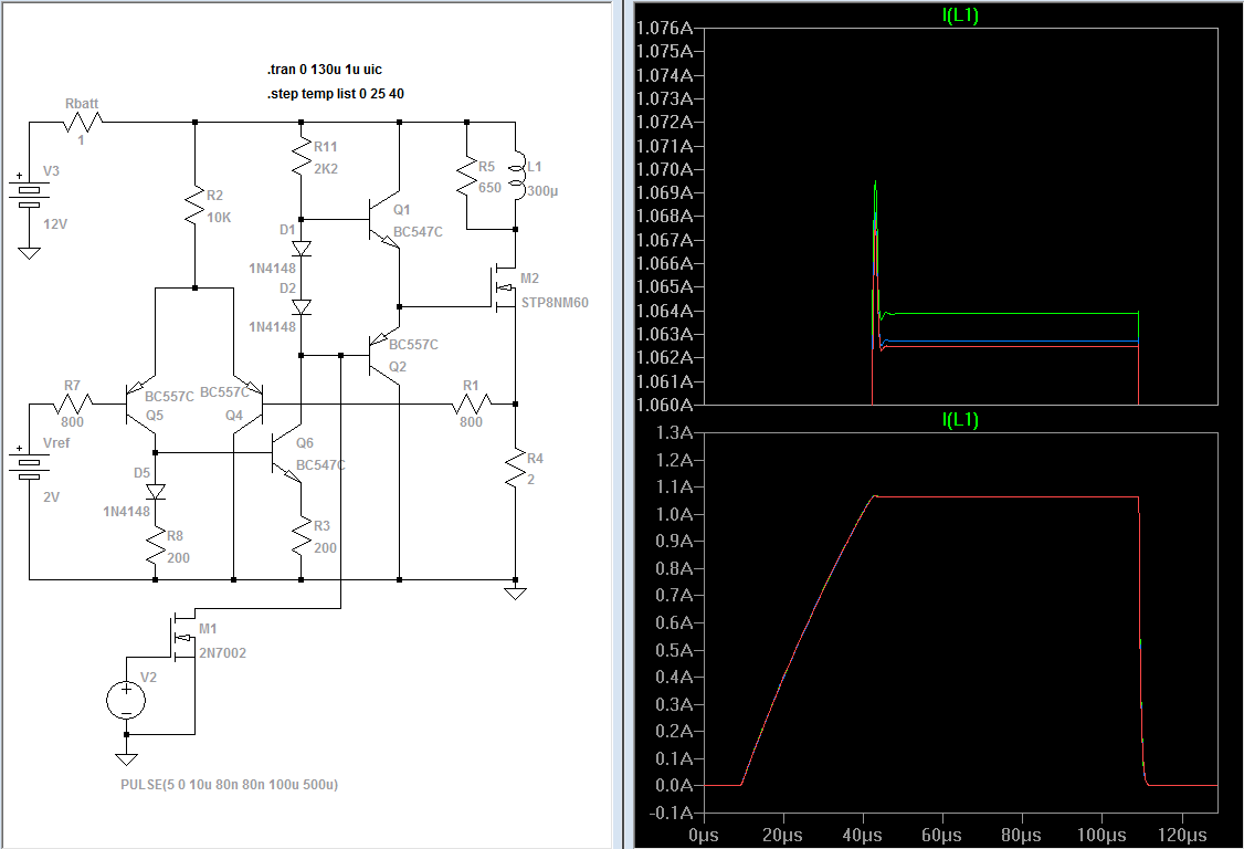

I've drafted this current regulator which is basically a simplfied Op Amp.
The problem is some MOSFETS ring, I know it has a lot to do with the Op Amp seeing the gate as a capacitive load.
Any ideas on how to get rid of it?
