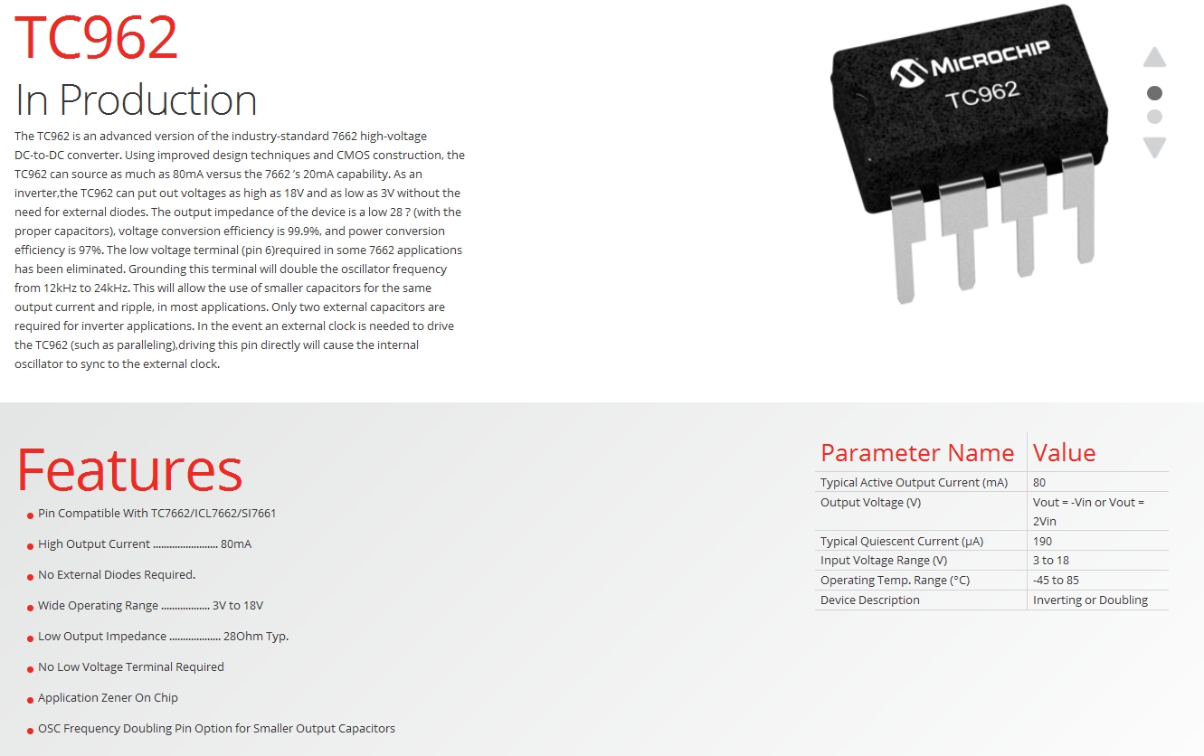

    Having had troubles with the 7660S series in the Baracuda & Surf Pi, I had a closer look
    at the data sheets and whats new on the market. This list is by no means exhaustive.
    Perhaps someone here has found a solution that is waaaay better. Please do post.
    I couldn't find the explicit data specifying how much output current the 7660 series can supply.
    This reminded me of metal detector advertising "Beware of what is not directly mentioned or hidden in footnotes" or so ...
    I found the data indirectly in advertising for a newer "better" chip:
    So I was wondering if the 7660S in my circuit is on its knees, because my Surf PI is already using 30mA without coil, speaker or led.
    I will be testing the TC962 when I get them. I have not looked deeper into the LT1054, except that it costs quite a bit more than the TC962.
    Does anyone know if the more expensive LT1054 has any advantages that justify the price in the Surf or Baracuda?
    Here is pricing incl. Vat in Europe for 10pcs PDIP, Consumer version, from distributor (real chips, not re-labeled or so ...)
    7660S 9.00 Euro
    7662A 16.10 Euro
    TC962 18.80 Euro
    LT1054 47.80 Euro
    What are your experiences/ideas with these Inverters?
    Thank You!

    The LT1054 has been qualified for use in the New Geotech Baracuda. The TC962 looks good in terms of specs. Those prices seem high but if they are genuine they may be worth it.
      If you need more current and higher voltage, LT1054 is a workhorse you need, but at slightly lower efficiency because it is a bipolar technology. 7660 and TC962 are CMOS, which means they are much more efficient at lower currents than LT1054. In most cases you do have low currents, and CMOS is an advantage.
      I can't source TC962 locally so I did not try it yet, but specs are great.

            Polymer, the TC962 looks like a very good part and is cheap here in the US, just a bit over $1 each. Have not tried one yet though.
              Also, the LT1054 and TC962 are happy with a wider voltage supply range compared to the often tortured 7660, along with generally more favorable spec, so it's a good replacement all in all.
              It's always good to de-rate/overspec parts for reliable long lived use. Output resistance (eg. voltage drop under load) also rises with temperature, and those finger burning 7660s might have closer to double the output resistance.

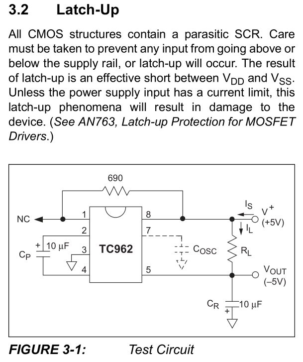

                  Questions to the electronically adept among you, because i don't understand it and I'd hate to have it happen.
                  I have been going through the data sheets of the tc962 and found this concerning latch-up:
                  Does this apply to the way the tc962 could be used in the Baracuda or Surf PI for the power supply?
                  What could simply be done to mitigate this?
                  I didn't understand the AN763 pdf mentioned:
                  00763c1_cmos_latch_up.pdf
