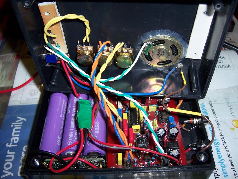

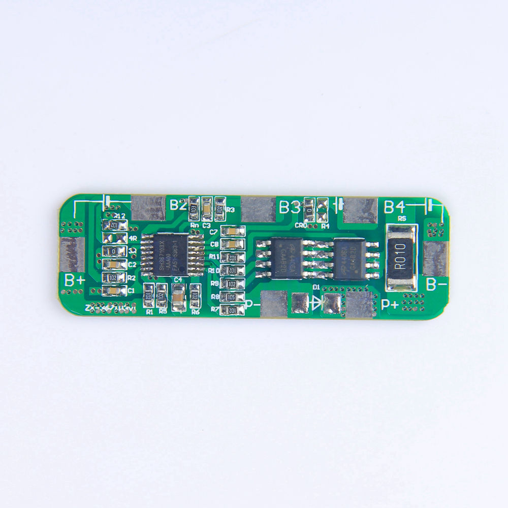

              Great piece of home-made kit there! If anyone with access to Ebay wants to buy a similar thing (US$4 approx.), search Li-ion charge controller. I use it to charge 3x18650 Li-Mn's from an unregulated 12v source (or solar panel). Small enough to fit on the side of the battery holder.
                Or you can just use one out of a old Lap Top battery like I did.
                  I use this charguer and work very well!!!!
                  Carlos

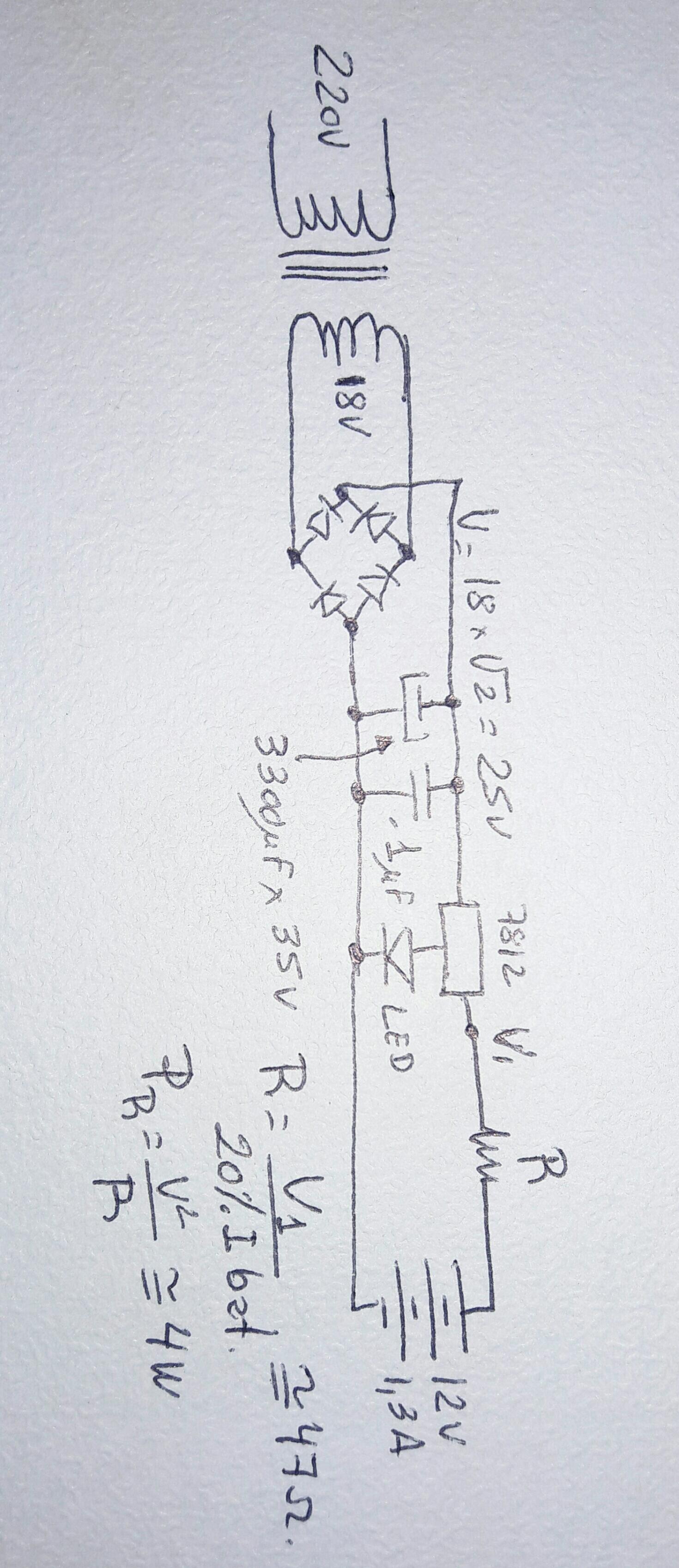

                      Originally posted by totob View Post
                      Hi everyone
                      I want to identify the components of this circuit (battery charger)
Name:	concept of battery serial.jpg
