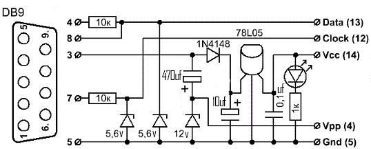

    Did anyone have try this diy programer?
    Im already make one but dont know if this is working or not, i dont have the ic yet.

          You show a version of JDM programmer. It should work. I personally like another version of this programmer. It works perfectly with proper installation of the elements.
          This version allows the programming of more PIC chips, but as you know this type of programmer can't program all PIC chips.

                  If you do displayed my version of JDM programmer then you will have the opportunity to program the 18F2550, which underlies PIC KIT 2.

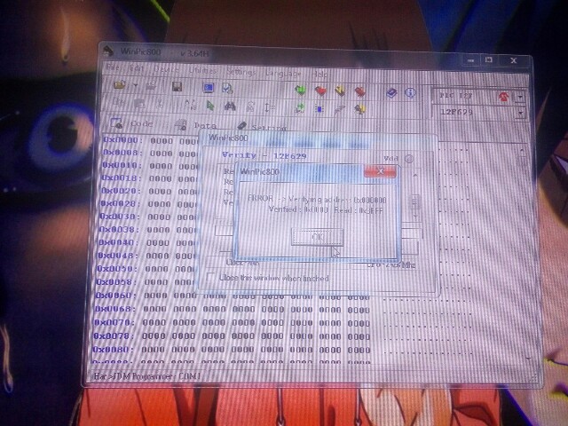

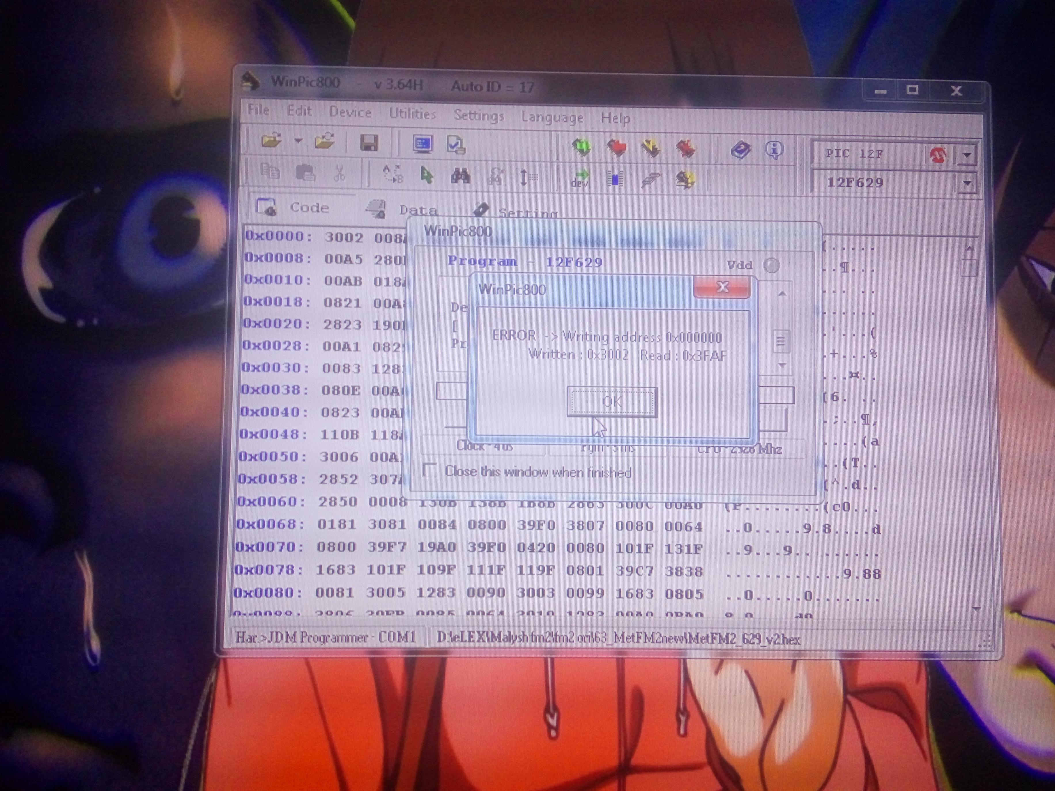

                      I just got two12f629 and try to use it with FM2 hex, but always fail when writing with jdm.
                      Can read and write after read, errase, detect chip.
                      But fail when using hex file
                      Verify warning:
                      Fail write warning:
                      Using windows 7 32
                      Winpic800.

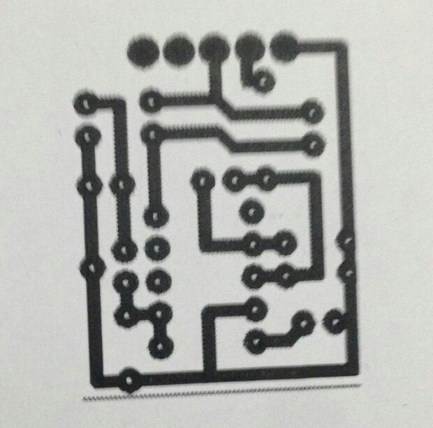

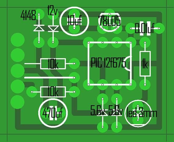

                            Mehhh.. wrong resistor, all perfect. For those want to be economical use this:
                            Serial com diy

                            Use wxpic and serial com as interface
                            ITS WORK!!!
