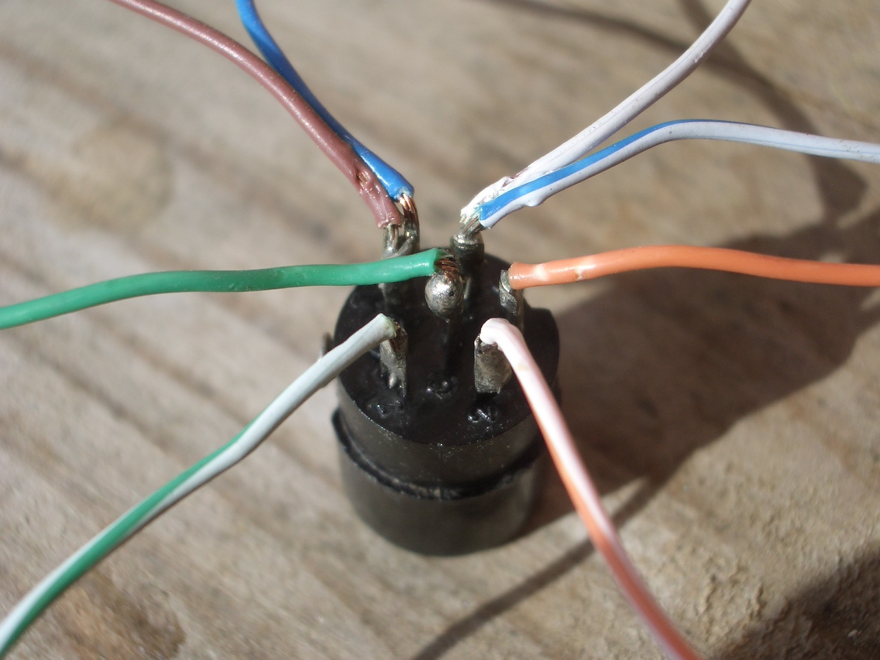

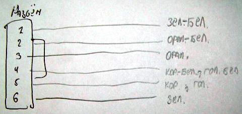

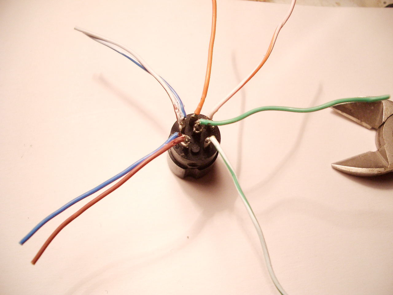

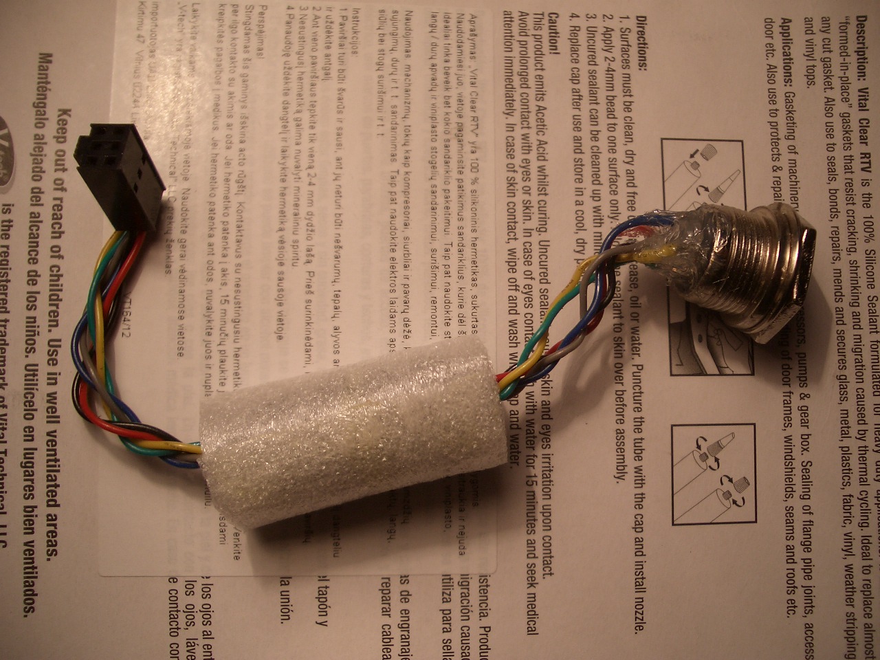

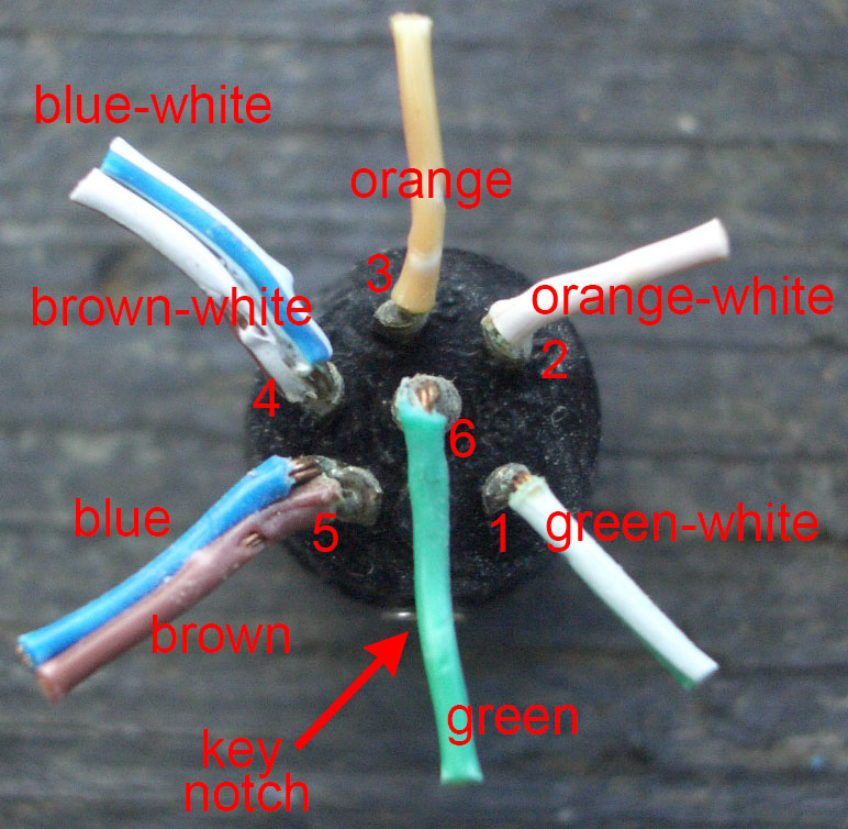

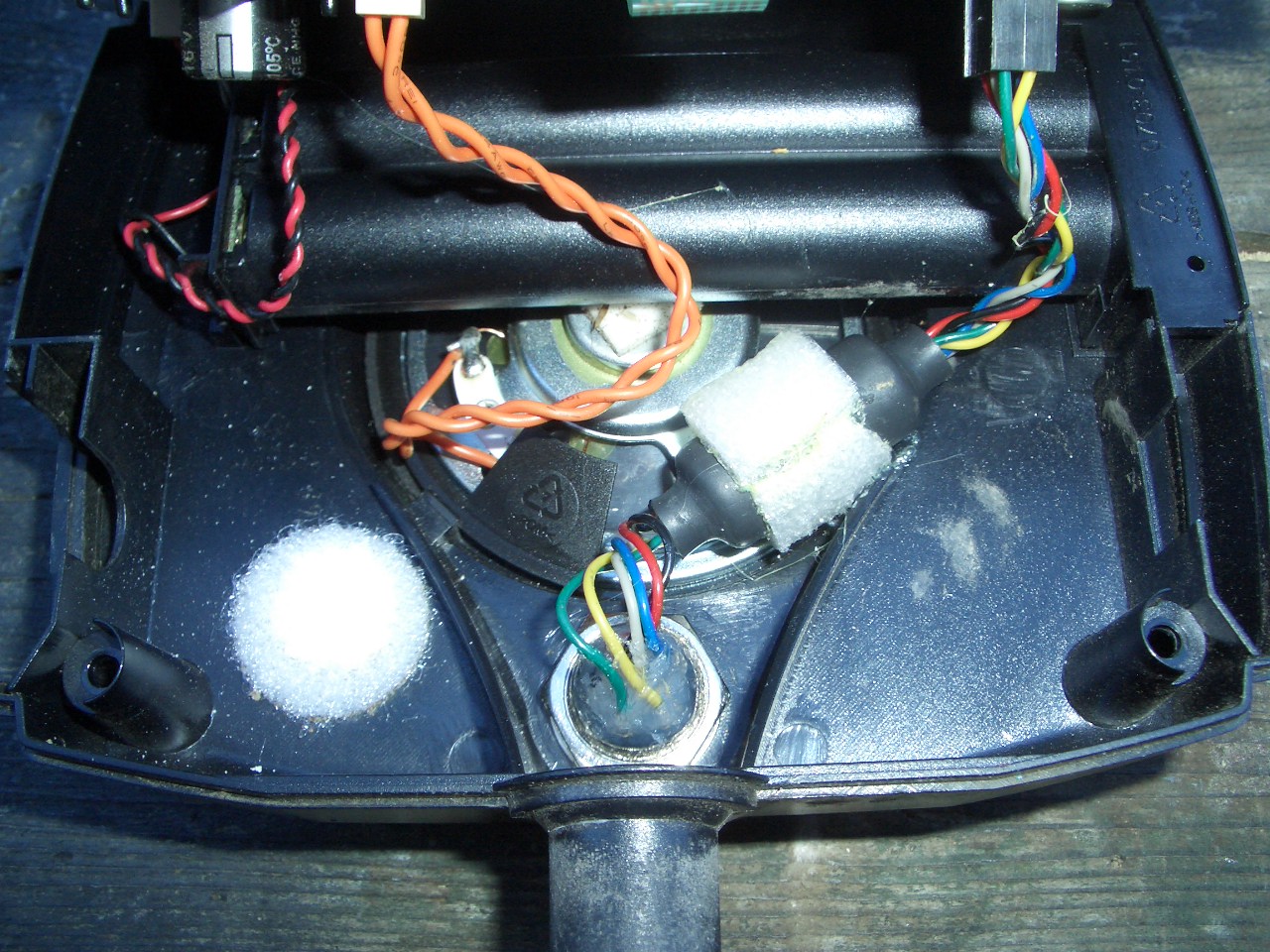

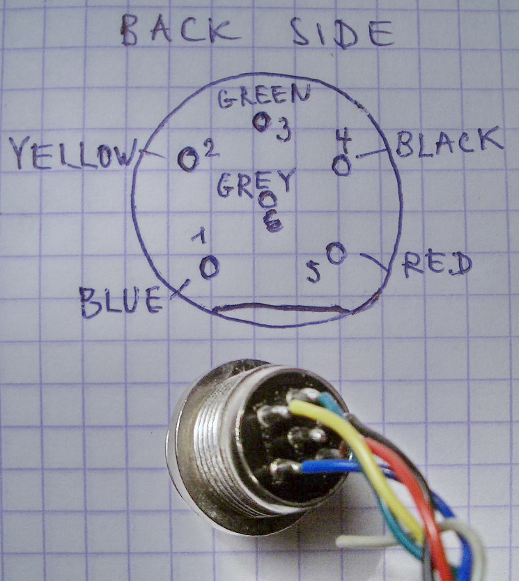

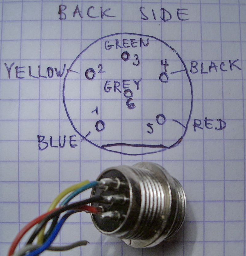

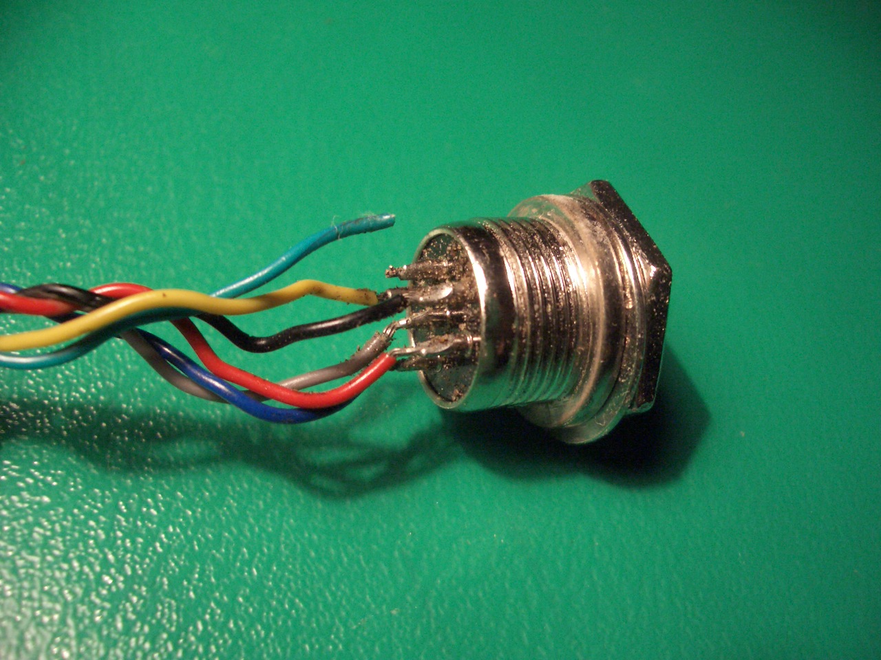

    Hello colleagues, caught me a detector minelab x-terra 305 of which jack located on the box are interrupted cabling to the board, generally 6 cable .If anyone knows how to tie please help.mersi

      thank you very much:aclamaciones:k Спасиба
        you are welcome
