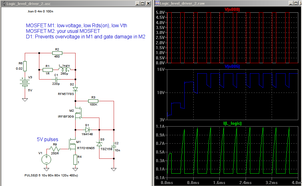

          For simplicity: Logic-level MOSFETs, 5V microcontroller, 5V Op-amps (TLC082, etc...), all powered by a USB rechargable battery.

                If a PI circuit you won't use a logic level mosfet...
                  Such a power bank can get down to 4.3V or lower with rated output loads.
                  According to the datasheet, the chip uses boost converters that can maintain 2.1A at 5V. Should be enough.
                  I'll be using a logic level MOSFET in cascode configuration with a High-voltage one (see this thread) . Energy recovered in a capacitor provides the medium voltage required to bias the cascode top gate.

                    I just don't agree with the premise that a detector using a 5V power bank is better than one using a dedicated battery. I think the parts count will be higher and detection no better. The circuit you refer to for the coil drive still uses a 12V source so I'm confused - are you going to add a 5V to 12V boost for this?
                      I would be more efficient since Power = V x I. For the same I, a given number of cells last 2x longer.
                      Part count needs not be larger because (1) no 5v regulators needed for the uC, (2) direct driving of logic level MOSFET, (3) the converter is part of the battery.
                      The circuit I refer to is a cascode with the energy recovery part removed. It's this part (basically a diode in series with the coil and a cap) that generates the 12V for the gate of the top MOSFET. In other words: the coil itself is the boost circuit that supplies the higher voltage.
                      Here's the 5V circuit:
                        If you have a look at DaveJ's PI its almost all +5v.
                          As I see it, it's almost all +12V.
