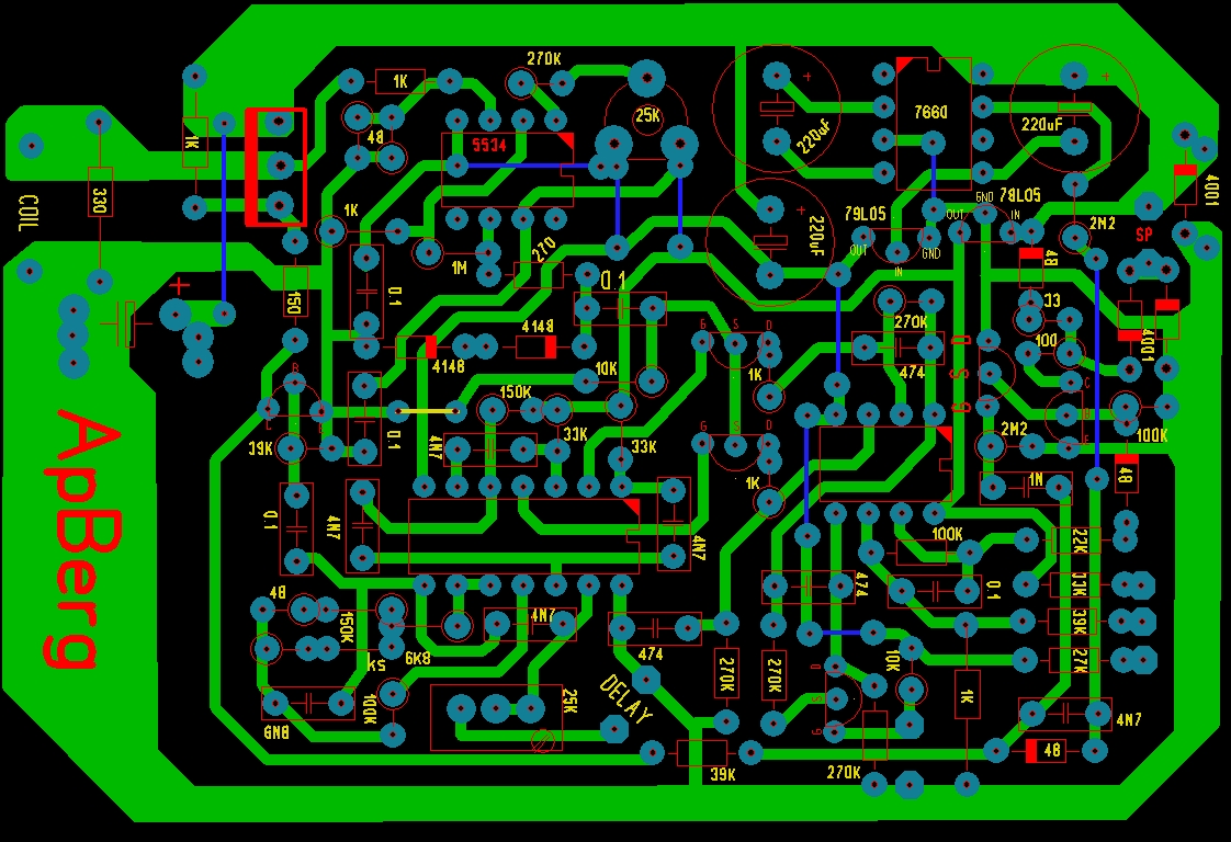

    Why did you add R35 100k ? thanks
    • #47
      Ivconic
      Good question!
      Because... i don't know?
      It is taken from old schematic from the past.
      That resistor does not exist on pcb which i used here:
        [ATTACH]39191[/ATTACH]
        Thanks so I guess its not required ?
            No, it is not required.
            It is missing on my pcb.
            Barracuda is working just fine.
