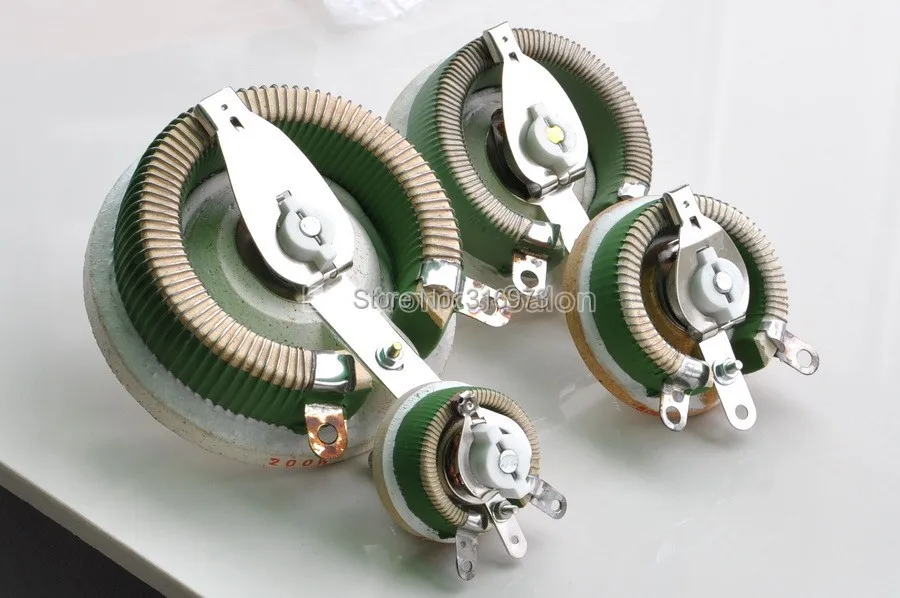

    I've seen different suggestions for resistance but don't remember seeing anything on pot material. What should I purchase(carbon, cermet, conductive plastic or wire wound)? How many watts? What resistance is best? Assume no avalanche current. For 1amp peak coil current and 5amp peak coil current, 1000pps. Other than maybe watts does 5amp peak coil current effect selection? I've searched but haven't found anything on allowable short term peak current.
    Ordered two of these for the price. Work fine. Do get warm if you run them for a few minutes. All available Current is not running threw it. http://www.banggood.com/WXD3-13-2W-1...l?rmmds=search

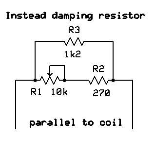

              "Damping tool" ?
              Something like this?
                      "Damping tool" ?
                      [ATTACH]38786[/ATTACH]

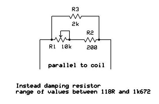

                      To get a slightly improved version:
                      Replace R2 with a 200R, and R3 with 2k. This will provide a range of values between 118R and 1k672.

                              Qiaozhi has wrong.
                              Min resistance is 181 not 118 Ohms
