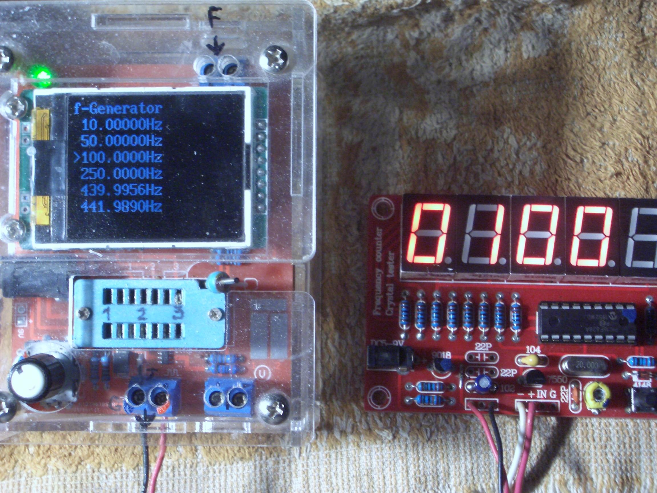

  • calibration of frequency counter

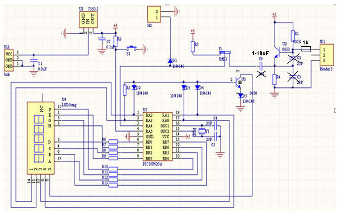

    • corrected FC schematic.

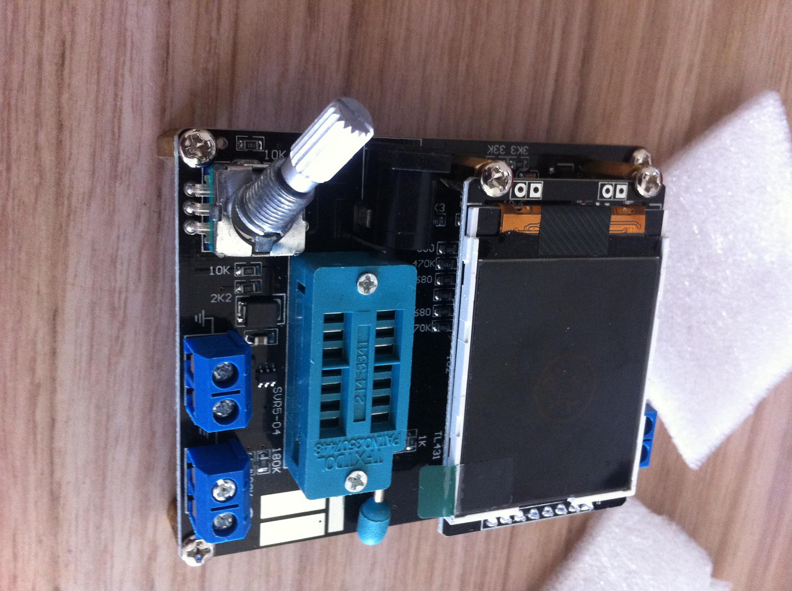

ID:	356457 I got a GM328A tester from eBay, only to receive it broken because the seller ship it in a plastic envelop.
          the rotary encoder with switch was snapped in two.
          I wander if anyone has the part number for it or can give a link to where I can buy one?
          there are many on eBay all looking physically the same but with different functionality.(i think)

            Claim a full 100% refund from the seller, it they refuse start a claim in Ebay, done this a few times because of similar problems

              i did get my money back,
              they don't want the broken back so if i can fix it i can use it.

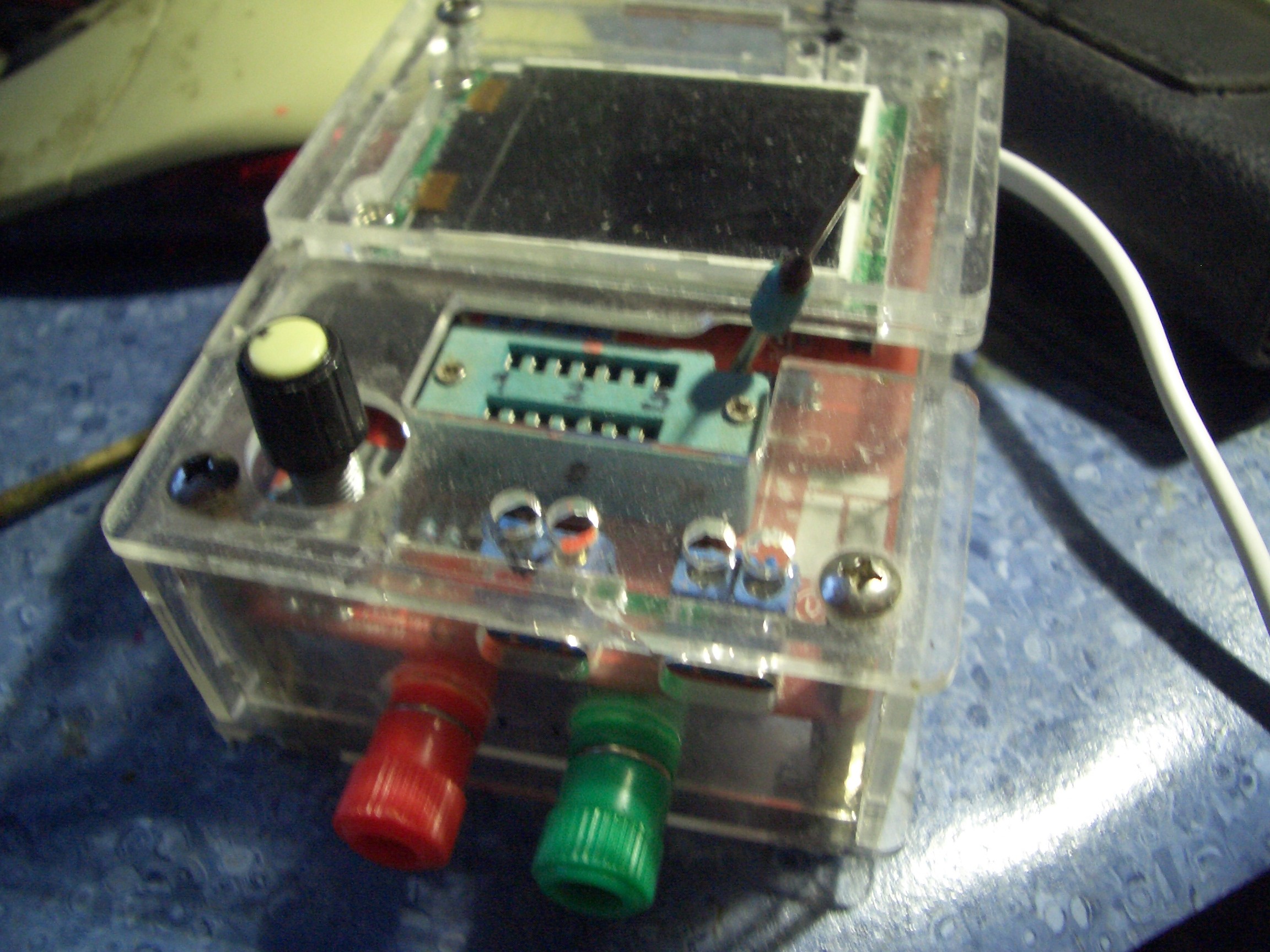

                  • did mods...
                    did add banana female sockets, it gives now possibility to use all kinds of probes from testers.​
                    glued a piece of broken drill into the lever of micros socket. the lever was short to use.
