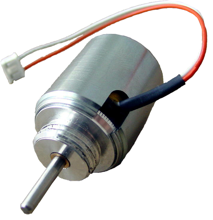

    How would you implement an inductor that can switch between two values without changing its resistance?
    The solution that comes to mind is a linear actuator, solenoid or latching solenoid moving a piece of ferrite in and out of an inductor on command.
    Any other ideas?

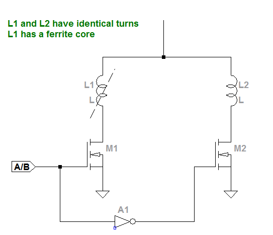

    Another idea, all electronic:
    It will never achieve exactly the same resistance but it may come close.
      You could even PWM drive the FET's independently then "crossfade" the values ;-).
      Works with Caps too!
        That's right but only when your Tx frequency si much ower than the PWM frequency.
