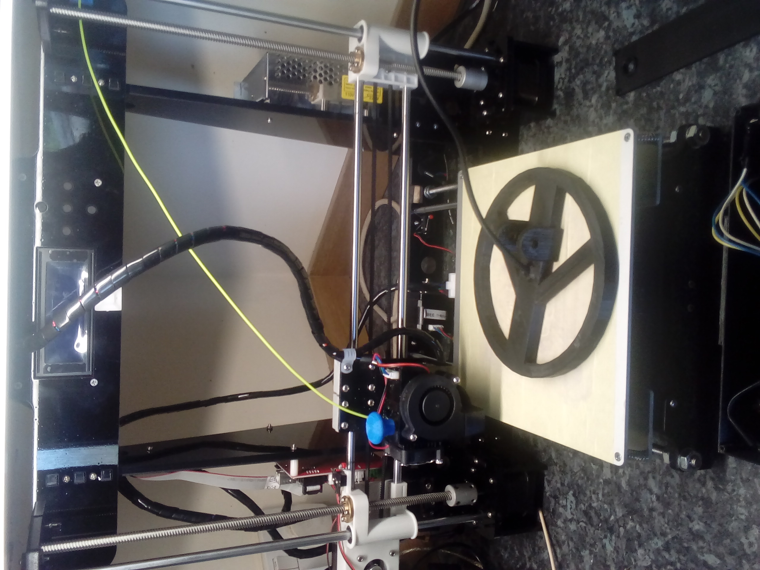

this is the best buy yet what a nice printer, what a hassle setting it up though you go on the net and your head spins so i worked it out for my self here is a few pics what i have done so far
