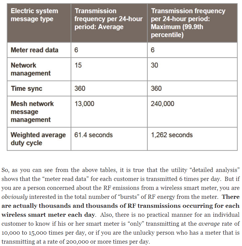

    I thought this might be interesting:
    The pulsing is 2ms or so as far as I have read and way more often than I thought.
    I am assuming that all pulsed signals will effect PI perfomance,
    no matter what the base frequency. Is that correct?
