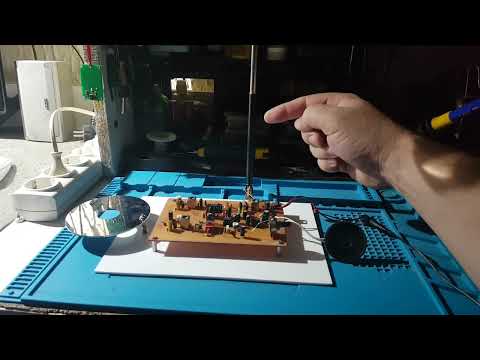

        I've already explored the net searching for a layout file (.lay or .lay6) but all i can find is schematics.
        That's why i think i'll make my own.
          I failed to make it right... but at least it is hilarious!
            That looks like fun.
            I think you need to shield your coil it seems to be picking up you hand.

                It's one of the simpler schematics, the theremin, easy to assemble.

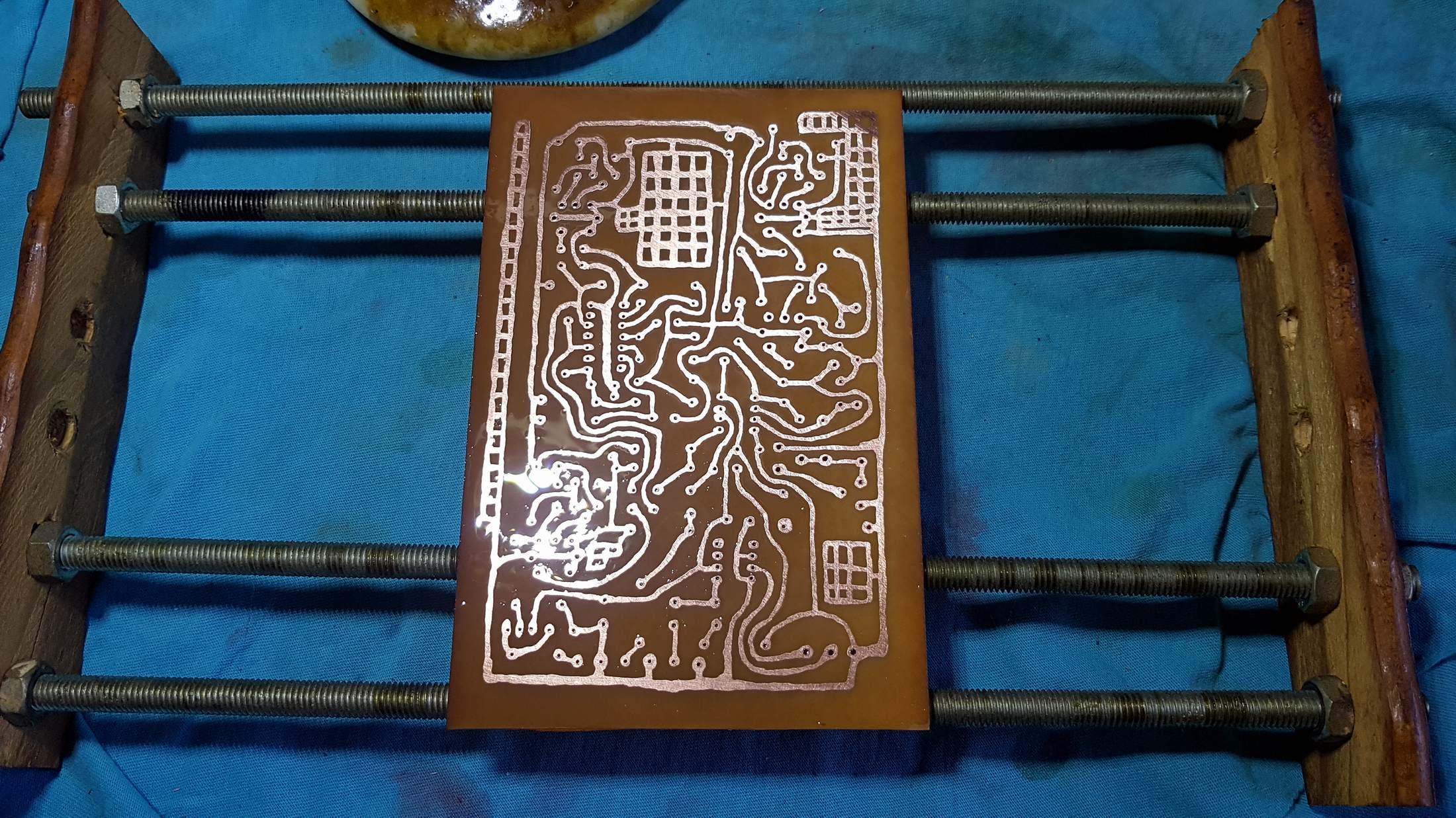

                I draw the pcb manually with nail polish! (haven't done that way for years)
                Because I was restless to see if it's gonna work at least something... anything.
                Pitch part obviously is working alright.
                Volume part, however; is not working correctly, there must be some flaws in that part.
                I am "hooked up" on this and I am considering making more complex design now...
                Madness never ends...
                  State of the art pcb!
