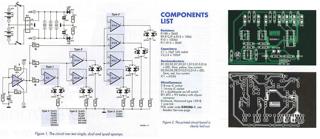

thinking to do it. i read again very much problems and people are not able to fix them.
so that will give a chance. i did not checked this schematic and doing as-is.
